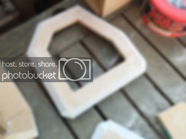

Slap the body filler on and sand back to seal the MDF edges:
It'll still require more filling after I find the defects after applying the primer.

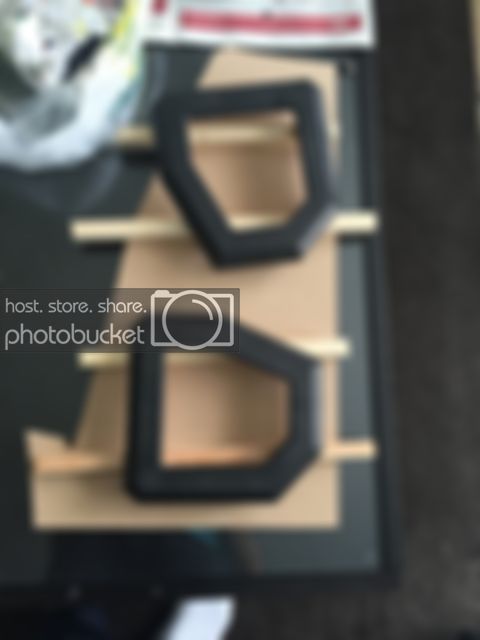

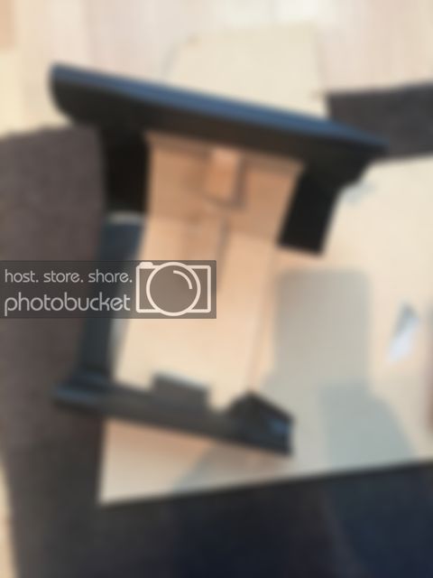

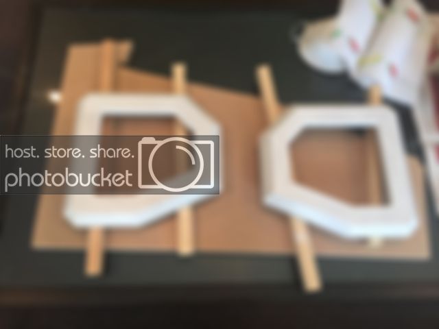

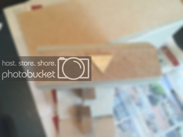

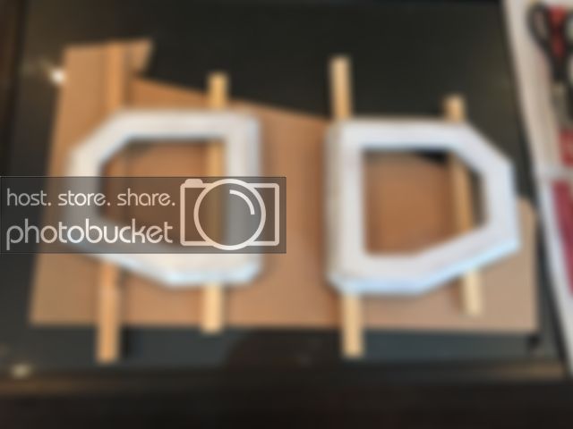

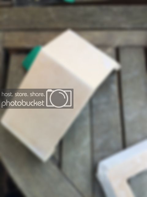

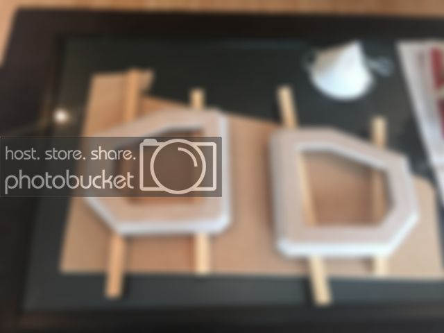

The headrest side panels have been prepared:
First undercoat applied:
Bracing has been made for the central shell panels:

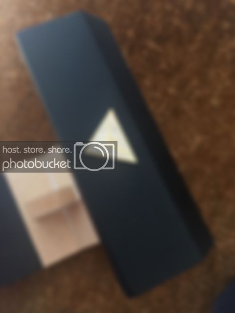

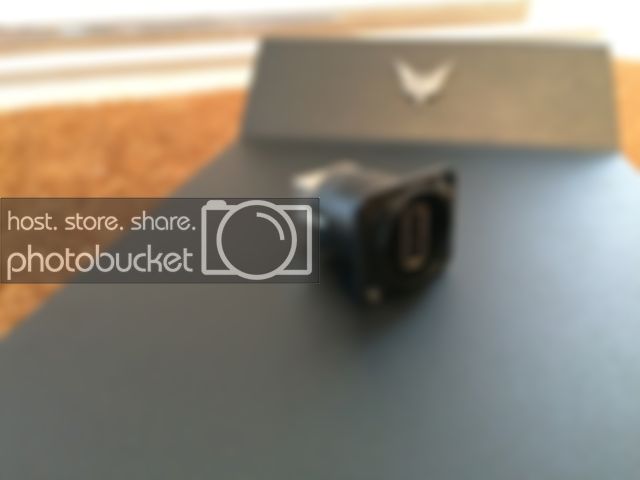

Holes drilled to fit the badge :
Sanded, marked, filled and sanded again:
I will start painting these black tomorrow. There's almost certainly a little more filling to do as well.

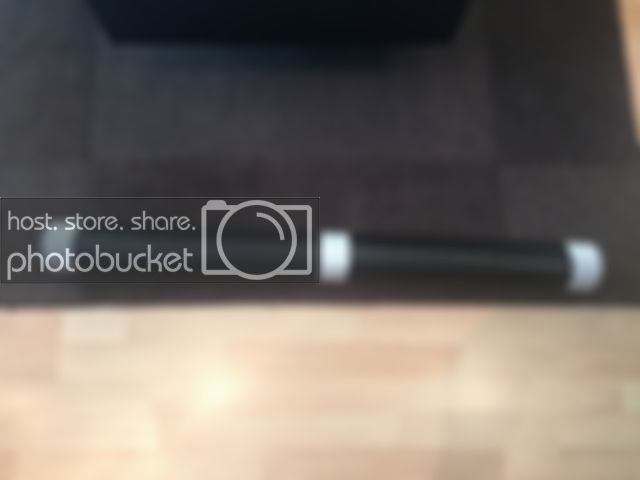

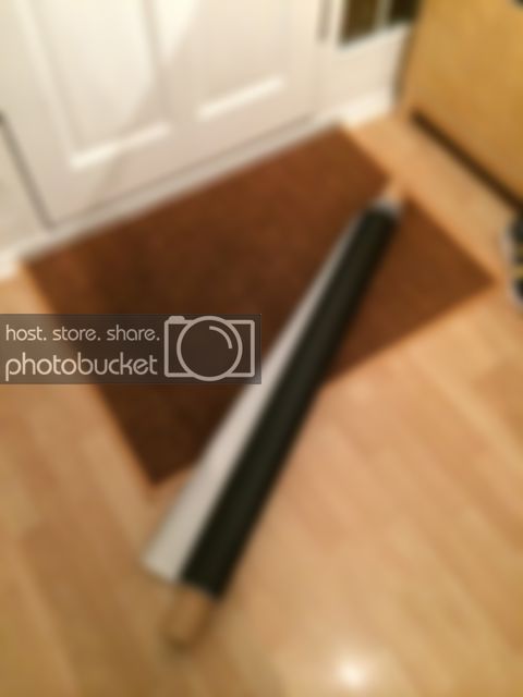

Hi hyperdennins, I use blackboard vinyl. It's thicker than regular self adhesive vinyl, is more durable (it's designed to be abused a bit), more forgiving when applying and has a great texture to it. I am addicted to it. I've replied to your question is 2 posts due to the number of pictures.
Vinyl:
It comes in approx 1m widths. I purchase it from here:

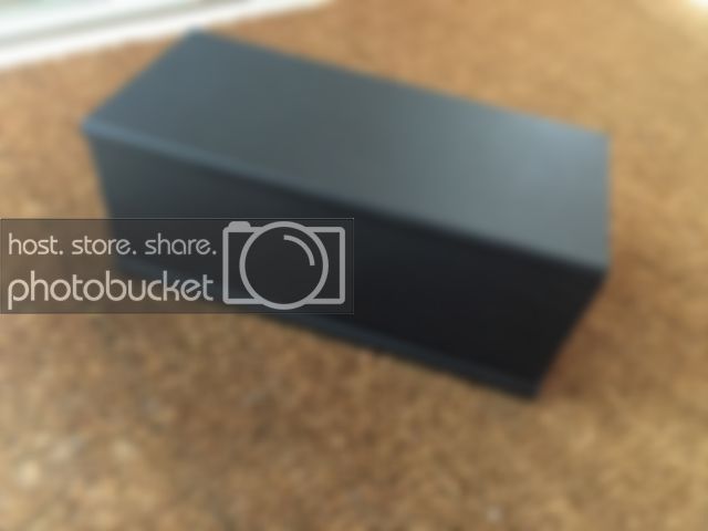

Close up of the texture:

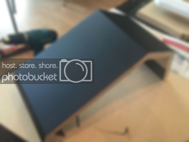

I have used it on all my current projects. It's durable enough to use on a desk. Here, I have applied it to the main surface, the front shaped section and also the custom built monitor shelf:

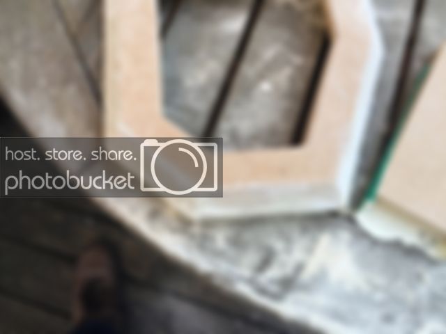

For panels which have screws embedded or are uneven, make sure these are filled and sanded. Avoid regular filled as this tends to crack and shrink. I use car body filler (p38):
Apply liberally to fill the holes:
Sand with a 180 grit sandpaper until smooth:
You can now dust and apply the vinyl.

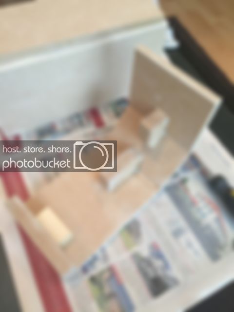

For more complex pieces across multiple planes where a single seamless stretch of vinyl is to be applied, I usually create some bracing to give the piece rigidity. Taking the front of the shifter pod as an example
Create some internal bracing to ensure the whole piece is well supported:
The panels can then be glued together along with the bracing. Wood strips are added so the bracing can be screwed to the outer panel:
