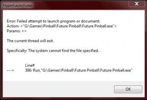

murpdog Posted January 11, 2012 Posted January 11, 2012 I am trying to load Future Pinball through Hyperspin and I am getting an error. I think I have everything configured, except this small error issue: It looks like it is trying to load Future Pinball from a G drive directory, but I have configured through hyperspin where the executable is located within the wheel settings. I have mame working just fine, can't figure it out how to get it to load. The videos are working for future pinball, theme, and everything except loading future pinball.exe Thanks for any advice.

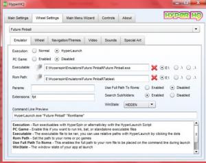

gixxer61108 Posted January 22, 2012 Posted January 22, 2012 my Hyper launch = **dont forget to compile*** ;********************************Future Pinball******************************** else if (systemName = "Future Pinball" && executable = "Future Pinball.exe") { hideDesktop() Hotkey, %exitEmulatorKey%, CloseProcess Runwait, "%emuPath%%executable%" /open "%romPath%%romName%%romExtension%" /play /exit %emuPath%, Hide UseErrorLevel } And future pinball settings ini try= [exe info] path=E:\hyperspin\emulators\Future Pinball\ rompath=E:\hyperspin\emulators\Future Pinball\Tables\ userompath = true exe=Future Pinball.exe romextension=fpt parameters=/play /exit/ searchsubfolders = false pcgame = false winstate = HIDDEN hyperlaunch=true This works fine on mine, good luck! I noticed you have Run, "E:\Hyperspin\Emulators\Future Pinball\Future Pinball.exe" in your ahk this could be the problem And you need to have "else" for your first emulator and "else if" for all that come after. Yea, I built one of each..
chillinwater Posted January 22, 2012 Posted January 22, 2012 @murpdog, what gixxer61108 said about "if's" and "else if's" You also posted a module for use with HL 2.0 and you posted just a snippet of the HL 1.0 script. Is that your actual HL 1.0 script or just a snippet? Make sure you know which version of Hyperlaunch your using so you get the right setup. The system script gixxer61108 posted is for HL 1.0 and if you use it (by copying and pasting into HL 1.0 ONLY) be sure to compile. also which verson of Future Pinball are you using? Your module is for HL 2.0 and "Future Pinball 1.9.1.20101231" I dont remember for sure but this command line parameter may not be compatible with earlier versions of Future Pinball: Run, "%executable%" /open "%romPath%\%romName%%romExtension%" /play /exit /arcaderender, %emupath%, Hide @gixxer61108, if your script works for you then dont change a thing, but... From DRD (The Department of Rendundancy Department)... Your declaring the same commandline parameters once in your script and a second time in your settings. May work for now but may cause problems in the future. Also not sure about this bit "/" in your settings but hey if its working....: parameters=/play /exit/ Game\Theme\Favorites\Genre - List Creation * FatMatch File Renaming for HyperNewbies. Like Me! https://hyperspin-fe.com/forums/topic/259-setting-up-un-official-systems-with-hyperspin/?do=findComment&comment=31034

volumetric Posted January 29, 2012 Posted January 29, 2012 Looking at your log, it looks like you don't have Hyperlaunch enabled for Future Pinball, also your command line looks wrong. It should look like this: "E:\Hyperspin\Emulators\Future Pinball\Future Pinball.exe" /open "E:\Hyperspin\Emulators\Future Pinball\Tables\50-50 (Bally 1965).fpt" /play /exit "E:\Hyperspin\Emulators\Future Pinball\" Which in Hyperlaunch, should look like this: Runwait, "%emuPath%%executable%" /open "%romPath%%romName%%romExtension%" /play /exit %emuPath%, Hide UseErrorLevel
