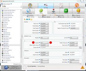

Now started to happen on both 7z and Images
Update: So when I delete all the SSF settings files and set it up again and manualy start the emu I can play games but whenever I run it of HS it somehow ignores my settings (goes fullscreen when it's set to windowed etc.) after that when I manualy run the emu it also doesnt work. :S
I see by Hyperlaunch version that your set up is not up to date, it's version 3.0.0.9, the latest is HyperLaunch v3.0.1.1c
You really it up to date before moving forward. Follow this guide to get it updated.
Also, if you haven't already get the latest Hyperlaunch HQ version from the downloads section 1.0.13.0
I updated HL and HLHQ now I dont see any emulators on the list : | BUT whatever I had set up earlier like Neo Geo CD works. Nothing changed seem like I might have some settings files paths issues.
Update: Managed to get the list to work, now it tells me I can't run 7z because it doesnt have the format listed even though it's clearly there in HLHQ at the very beginning of the list
Update2: So I finally managed to get it to work (forgot to enable 7z) but now I have another problem. HS seem to ignore my screen settings in the emu. I want to dissable scanlines (causes graphical glitches for me) but even if I turn it off in the emu (and it's ok when run manualy) it runs with them when I use HS.
