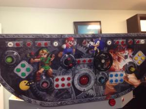

Trizzt Posted December 11, 2014 Posted December 11, 2014 Hello Everyone, My friends and just finished building a 4 player arcade style pedestal that was manufactured by Monster Arcades. Everything is hooked up, but we're having trouble mapping the controls to the emulators that are ran through hyperspin. Is there software we need to be able to map these controls? We're having a hard time trying to figure out how to map each emulator so we can play some games! I appreciate the help, sorry we're newbs.

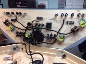

Trizzt Posted December 12, 2014 Author Posted December 12, 2014 Thank you so much for the help. It's been a pain wiring everything up. Now we just have to figure out these controls and buttons. Check out the wiring setup.
amrathe Posted December 18, 2014 Posted December 18, 2014 I have a spool of Cat 5e cable that I use to make my wiring runs. I just cut whatever length I need and with 8 wires per cable you need 1 length per button/joystick bank with it all pre-sleeved to keep the runs neat.
