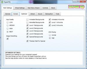

iNTiGOD Posted December 12, 2014 Posted December 12, 2014 Hi guys, Sorry if this sounds like a really basic question, but I have noticed that when i'm flicking through the game wheels, each time I choose a different game the theme background flashes black (for a second) and then the background appears. Its quite annoying when you are scrolling through hundreds of games. It seems to happen on most of my systems except for genesis? I've tried having a look through hyperhq but cant seem to find an answer? (I did look at the reload backgrounds option in hyperhq but its off for all my systems). Cheers George MAME High Score Tutorial For HyperSpin
gigapig Posted December 12, 2014 Posted December 12, 2014 I have reload backgrounds checked for all systems as most are lacking themes so that helps with the video snaps. You could maybe play around with the optimizer as well, I did have all the options checked, but recently unchecked 2 on someones recommendation. It's now a smoother experience.
iNTiGOD Posted December 12, 2014 Author Posted December 12, 2014 Hey mate! Thanks for the tip. I've updated as per your settings and now the black background flashes have disappeared. Although I have noticed a new problem since switching to these settings. The cart and cover (art 3 and 4) stops displaying now after I move from the first game. It only reappears now if I choose a game that had a theme. Then it stops working again? And the videos stopped working? MAME High Score Tutorial For HyperSpin
iNTiGOD Posted December 12, 2014 Author Posted December 12, 2014 All fixed. I turned off "themes wait for special". Cheers again! MAME High Score Tutorial For HyperSpin
danlester Posted November 1, 2015 Posted November 1, 2015 Thanks Gigapig and iNTiGOD Somehow I checked off a couple of the boxes mentioned in this post and my Game Themes quit loading correctly. The First Game Theme would load but not the next Game Theme and this happened throughout most of the systems. Once I unchecked "Wait For Special" everything started working correctly. Thanks for the hard work Dude Be Blessed Dan Lester
