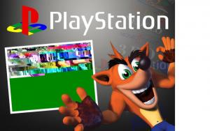

mrstaun Posted December 14, 2014 Posted December 14, 2014 the default videos in the HS Wheel are just flickering, different colors. Anyone seen similar and know what to do?

mrstaun Posted December 14, 2014 Author Posted December 14, 2014 hmm, looks like I suffer on this issue. Currently I am only configuring my HyperSpin, on the Cabinet computer I do have another graphiccard. Couldn't find anything about flashsettings though. But may have overlooked it Well thanks for the tip, no need to use more hours to find out why it doesn't work.
