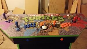

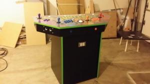

I just wanted to share my recently completed (and first) build. I've been beating around the bush for a while and finally followed through this time!
The body is built from 3/4" MDF. I designed the art and had Brad (Aka
Lucian045) print it on vinyl. Finally, there's a 1/8" sheet of lexan on top.
The controls for Players 1 & 2 are soldered to DB25 connectors which plug into a manual switch that can toggle between the IPAC encoder and xbox360 boards.

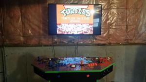

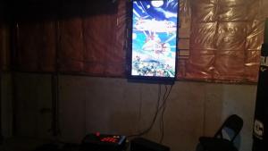

The TV is mounted to the wall using a mount that allows me to rotate the screen 90 degrees. All of the vertical games I have are configured to rotate automatically on the software side.. it's about a 15 second process to rotate the screen from horizontal to vertical and is manual for now.
