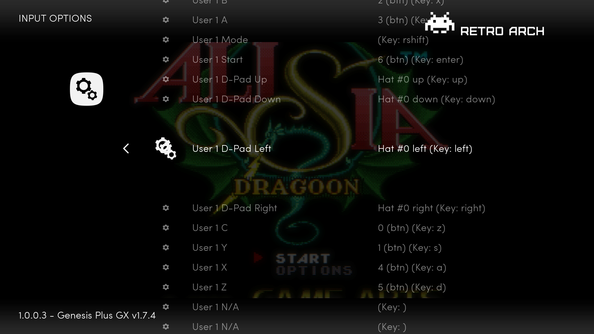

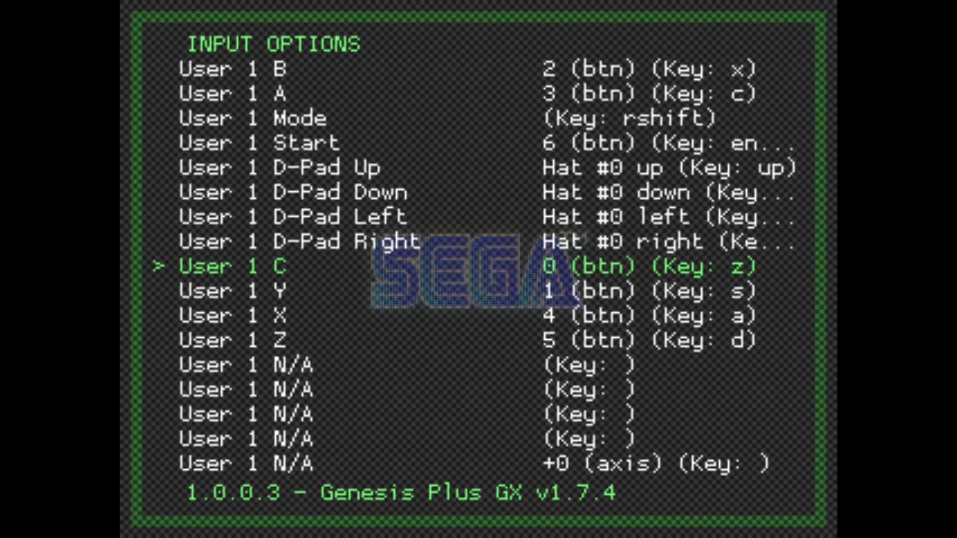

Awakened Posted January 3, 2015 Posted January 3, 2015 Actually, follow up question. I'm not seeing the input labels in the latest nightlies... Could you post a screenshot of what you're seeing? I just grabbed the 1-2-15 RetroArch and 1-3-15 Core 64 bit builds to check, and here's what it looks like: RGUI: XMB: You just have to scroll down pretty far to get to the user 1 bindings. One more follow up question, since we're basically running nightlys until 1.1 drops, it would be awesome if you could summarize the minimum amount of work required to keep all your settings when you change version, and also all your saves. Is it as simple as copy and paste retroarch.cfg, config folder, and save folder? I leave everything intact and just copy over retroarch.exe and the core files. Sometimes I have to update the .dll files in my RetroArch folder too if the new .exe needs them.

Awakened Posted January 4, 2015 Posted January 4, 2015 Setting the Bind Mode to RetroKeyboard just makes it so you can setup your keyboard binds, rather than pad. You should see an option in Settings, Input Options called Show Core Input Descriptor Labels near the top if you are using an new enough version. It's enabled by default. Then if you go down, all the way past User 16 Bind Default All and the hotkeys after that, you should see stuff using the descriptors instead of RetroPad assignments like in my screenshots. There are a few cores like MAME and Mednafen-WonderSwan that don't have descriptors yet, so those still show the RetroPad stuff. You can mix and match most versions of RetroArch and the cores without getting any errors, so for reference I'm using the nightly 2015-01-03_cores.7z pack and 2015-01-02_RetroArch.7z build. Since MAME and PPSSPP were missing from that core pack (probably compiling issues) I grabbed those two out of the 2014-12-30_cores.7z pack.
