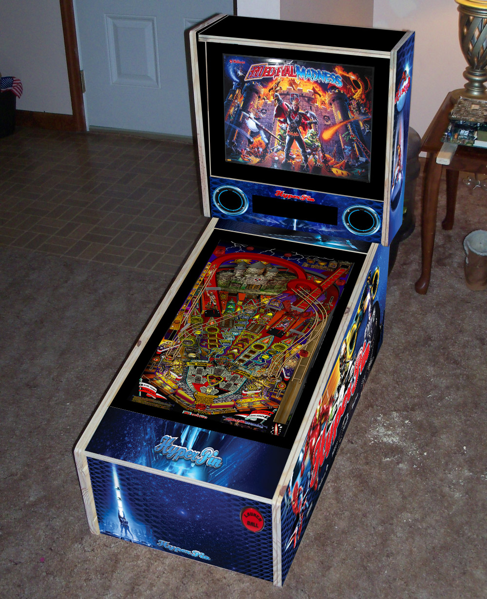

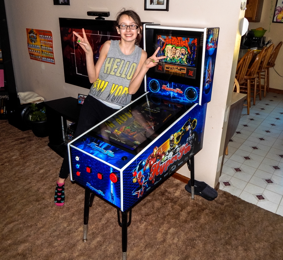

Tredog Posted January 22, 2015 Posted January 22, 2015 Here are the FINAL pics of the build: ------------------- ORIGINAL THREAD ------------------------------------------------------------------------------ Here are my plans so far for my Mini-Pin. At first I was just wanting to build it as cheap as possible thinking Pinball was not really my thing, however, now that I have gone through the tables and played a bit, I am officially loving it. I have already purchased most of the parts to build an arcade style pin machine, but am already planning on building a true looking pinball down the road. Using an asus 24in IPS for the playfield and an old 17in Neovo 4:3 Monitor for the backglass. http://www.newegg.com/Product/Product.aspx?Item=N82E16824236335&cm_re=vn248-_-24-236-335-_-Product    Â

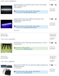

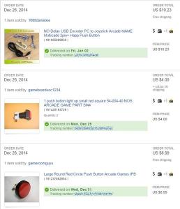

Tredog Posted January 23, 2015 Author Posted January 23, 2015 PARTS LIST SO FAR: 4 X 16x36x5/8" Project Boards ... $7.50 each 1 X 16x72x5/8 Project Board ... $14.00 Used HP p6610f Computer (Win7) ... $0.00 (was being recycled) OCZ Vertex 4 (128GB) SSD ... $0.00 (Old SSD Drive) MSI ATI R5750 Video Card ... $0.00 (Dad upgraded and gave me this one) Asus 24" VN248H-P IPS Monitor ... $135.00 (Open Box Newegg.com) Neovo 17" 4:3 Monitor ... $0.00 (First LCD Monitor, still laying around) Dell 2.1 Speaker System ... $0.00 (was being recycled) No Delay USB Encoder ... $10.23 (Shipped from china) All Chrome Arcade Buttons, Large Launch Button, and Fake Coin Buttons ... $29.64 LED's to replace the non LED buttons ... $5.95 White 5/8 T-Molding (40') ... $18.00 RandR's Bam kit w/Belt Clip ... $106.33 2" Speaker Covers ... $3.40 LED Tubes (one violet, one white) ... $21.90 4 Channel Fan Speed Controller ... $8.59 (From China) Total ... $383.04 Software: Window 7 x64 PinballX 204 Tables Future Pinball    Â

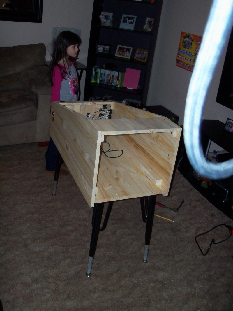

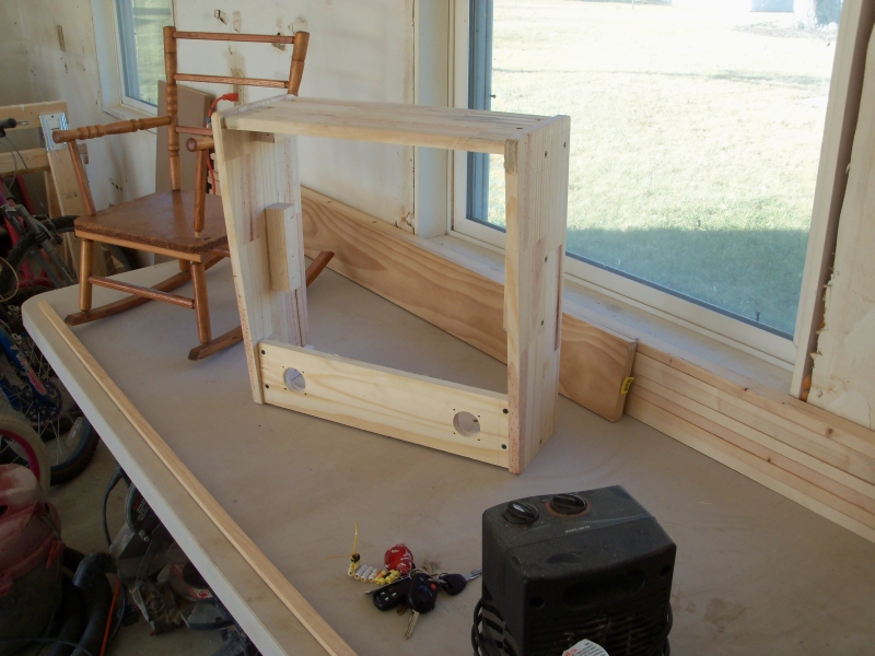

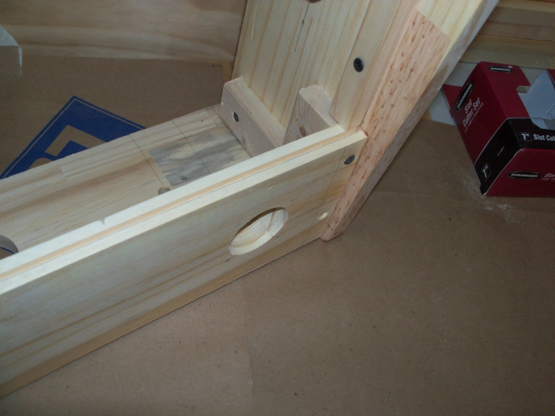

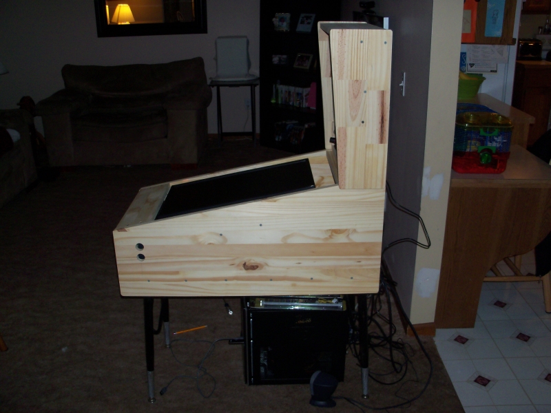

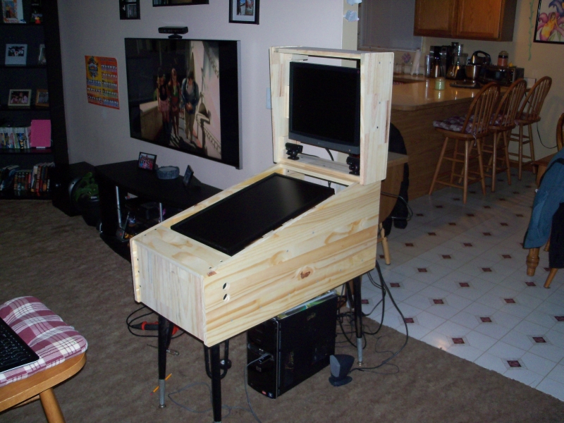

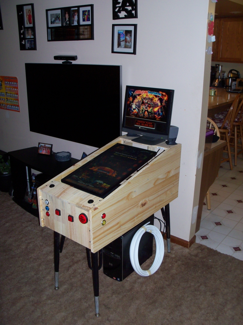

Tredog Posted January 23, 2015 Author Posted January 23, 2015 Progress so far: Cut the angle for the sides, rounded edges (rough still) Cut the bottom and test fit sides Cut temporary front, palm rest, and backbox rest Test fit all buttons, speaker system, and playfield screen Test fit the repurposed legs that arrived today (Think these were on a small school lunch table, smells of spoiled milk, lol) Â Â Â Â

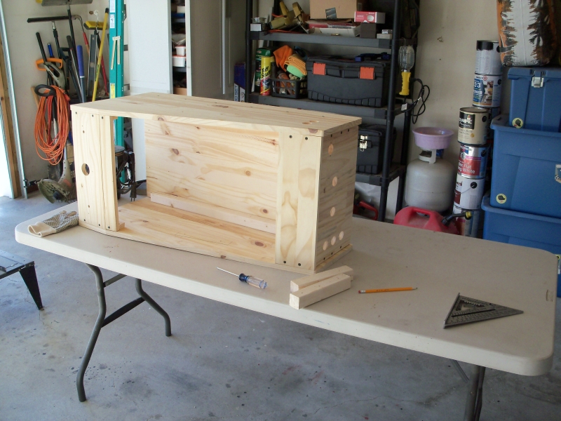

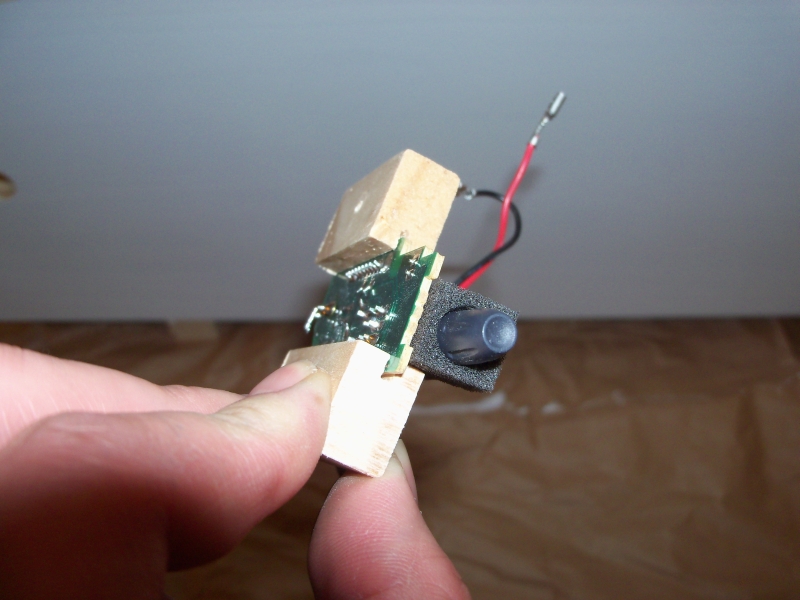

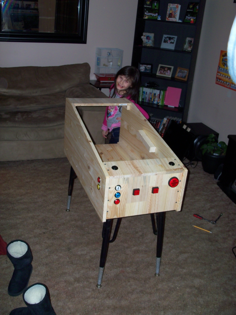

Tredog Posted January 25, 2015 Author Posted January 25, 2015 Made some progress today, but it fell short after RandR's IR Tracking Kit arrived. Set it up and played with it for an hour or so... New Pics: Â Â Â Â
Tredog Posted January 26, 2015 Author Posted January 26, 2015 I am no longer modifying my table for the PS3 Cams/IR Tracking Kit from RandR... I will just stick to the original plan due to the kit not working properly with the small cabinet size. The IR Tracking seems to pickup everyone tall and small from about the 4' range, my cabinet is only 3' deep. I tested them sitting on top of the backglass and it worked well for tall people, but not my youngest daughter (6). So if anyone is interested in buying the kit from me (Everything except the free t-shirt Paid $106.33 + Shipping + $2.99 Drivers + $4.99 SDK Software) Asking $75 + 10 Shipping (PM Me). If not, I will just mount them to a board that fits on the backglass for temporary use. My kids fight enough without me giving them another reason to, not leaving one of them out. Rick    Â

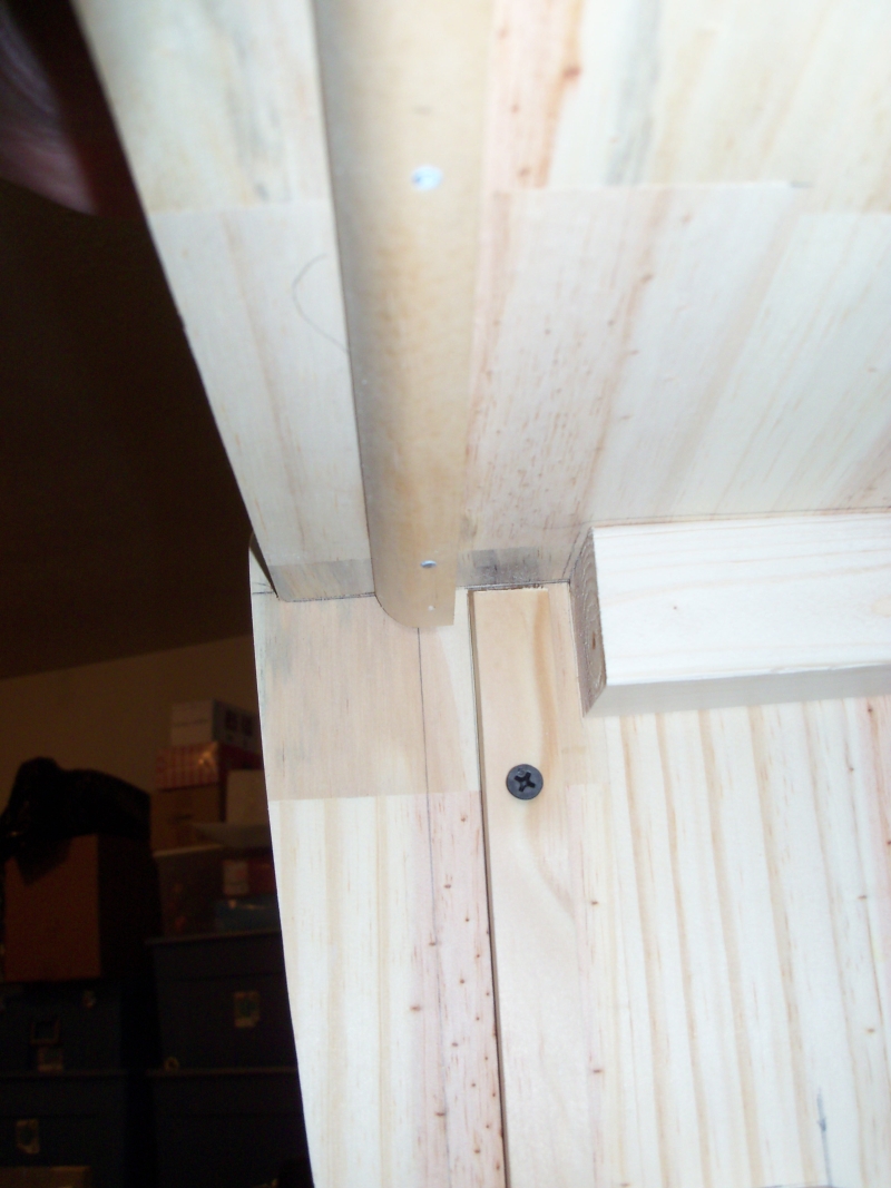

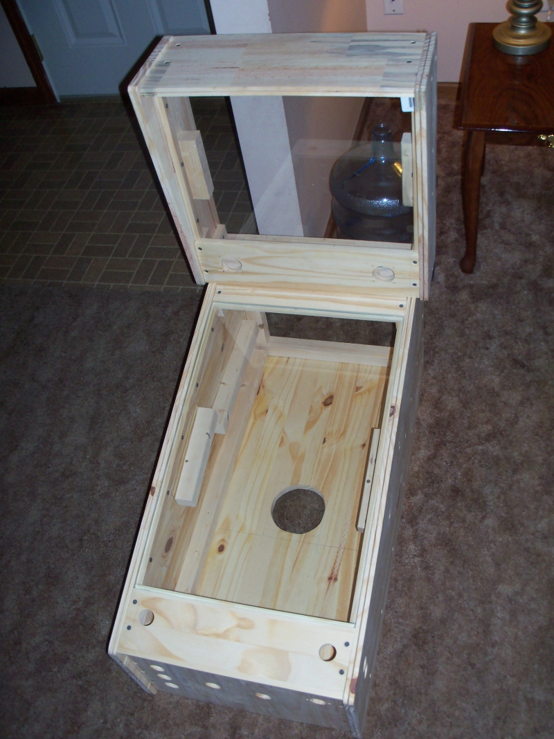

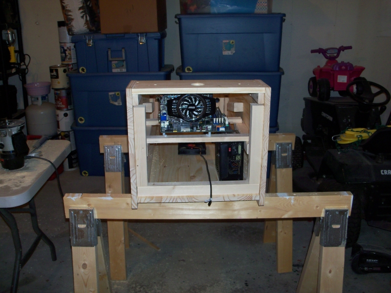

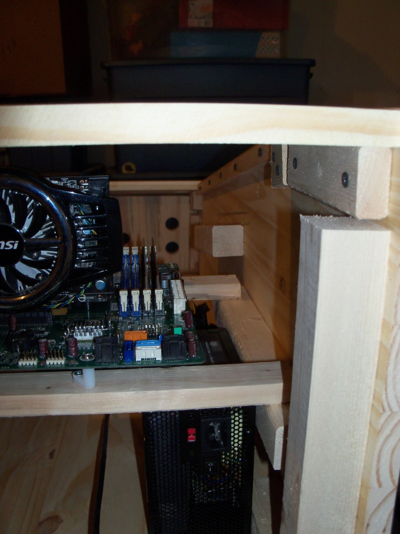

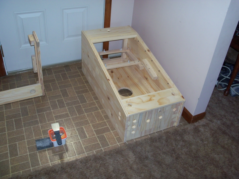

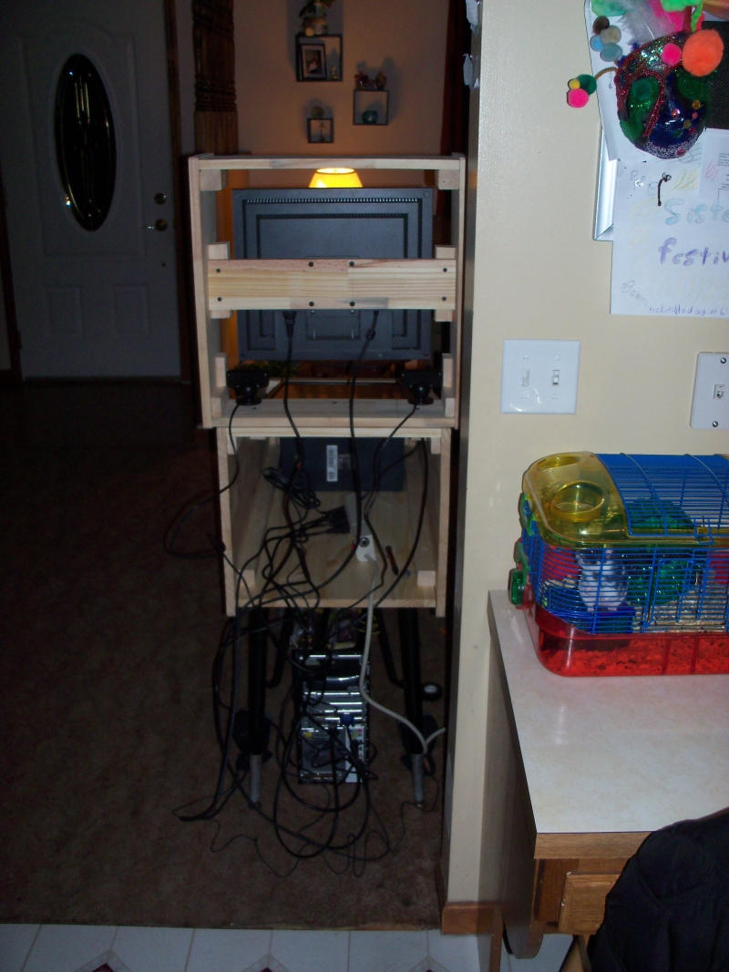

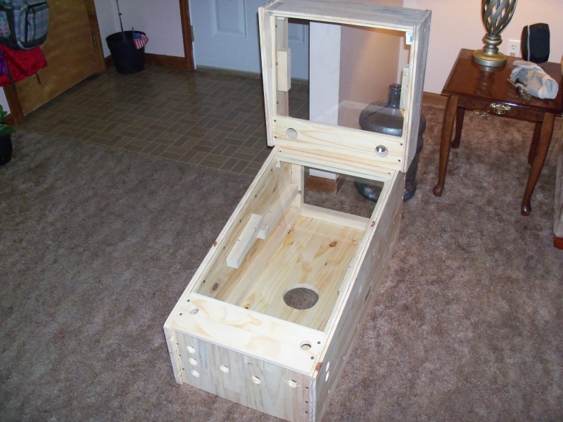

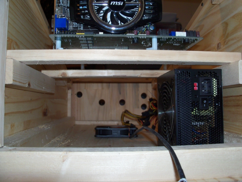

Tredog Posted February 9, 2015 Author Posted February 9, 2015 Made some progress today... Removing the legs: Getting Started: Disassembled Backglass: Routed Groove for glass to seat properly: Added Back Support wood, and Trim to top to sandwich glass between: Test Fit PC/Video Card/PSU/Cooling Fan: Routed and added supports for play field glass: Lower Half View of Test Fit: Upper Half showing play field monitor support: Looking Down from back to front: Â Â Â Â
Tredog Posted February 9, 2015 Author Posted February 9, 2015 Ready for wood filler, sanding, and primer. Sides are all routed for t-molding. This is how she sits till the next warm spell: Â Â Â Â

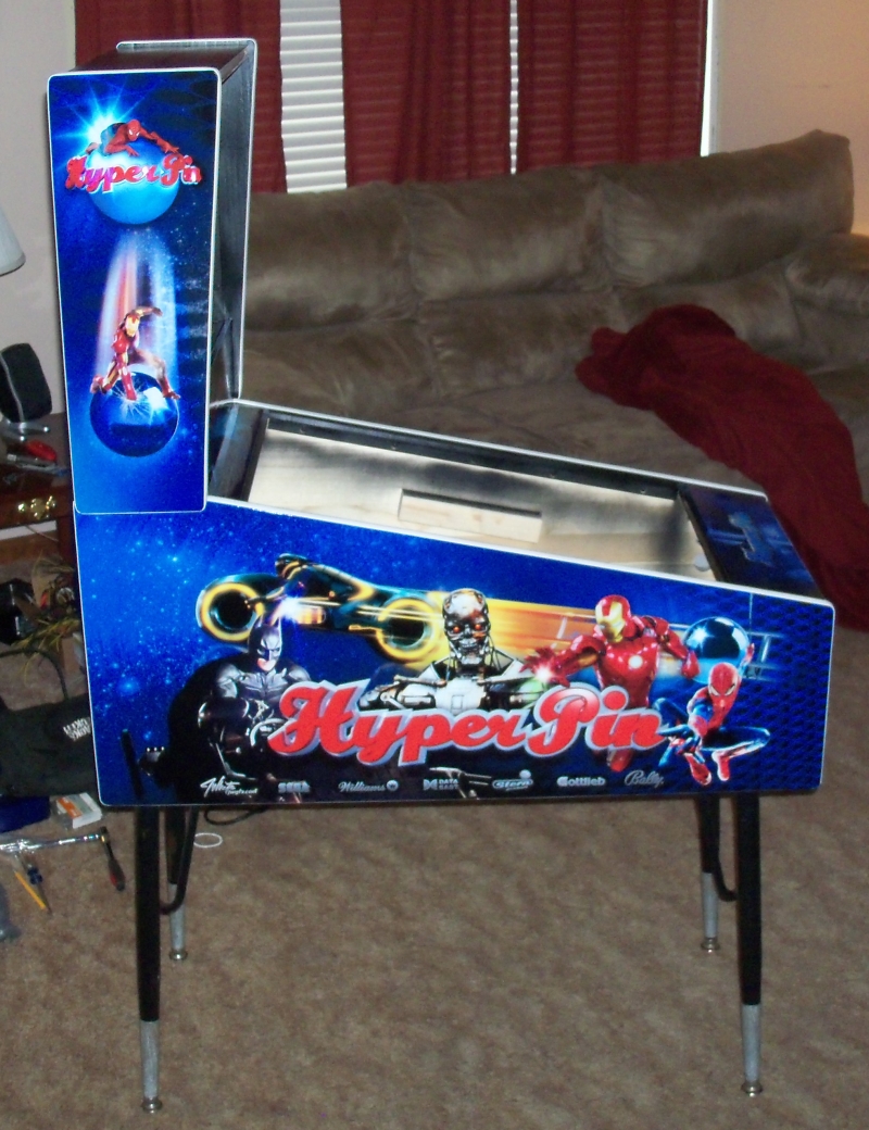

Tredog Posted February 13, 2015 Author Posted February 13, 2015 No Major updates, been too cold here near Cincinnati... Been spending this extra time to plan paint colors and possible artwork to apply. For those that have not found these threads, great artwork available here: http://www.vpforums.org/index.php?showtopic=26497 with previews of each here: http://imgur.com/a/MhlPm#0 Hats off to stuzza for making them possible!!! Here are the latest pics with glass: Â Â Â Â

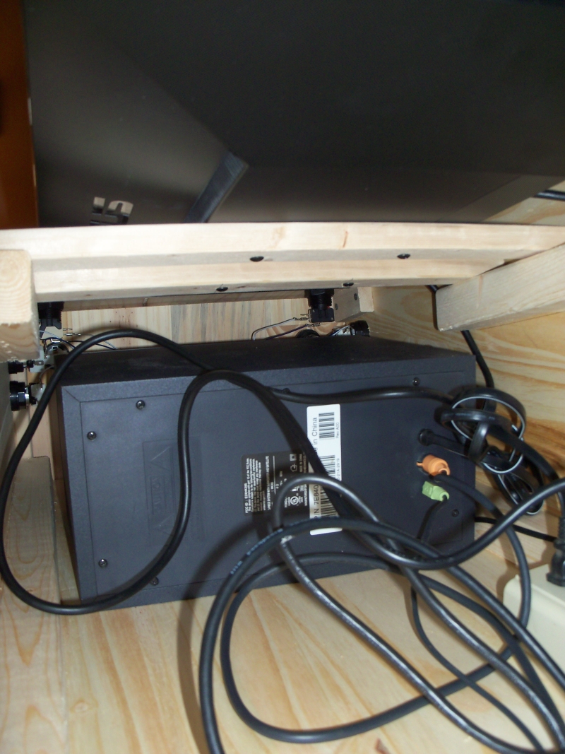

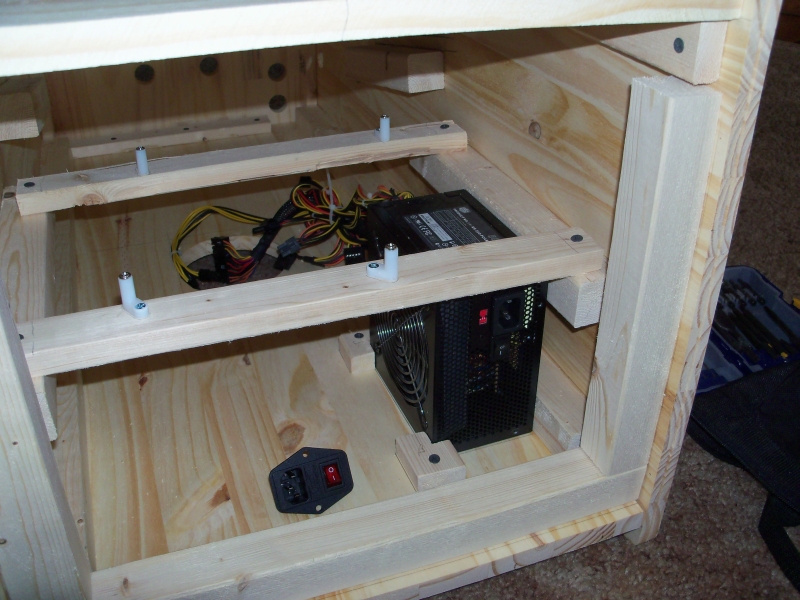

Tredog Posted February 15, 2015 Author Posted February 15, 2015 Made some progress today. Added Motherboard mounts/Power Supply mounts/ hole for power connector/switch. Started wood filler / sanding. Here are the updated pics: Â Â Â Â

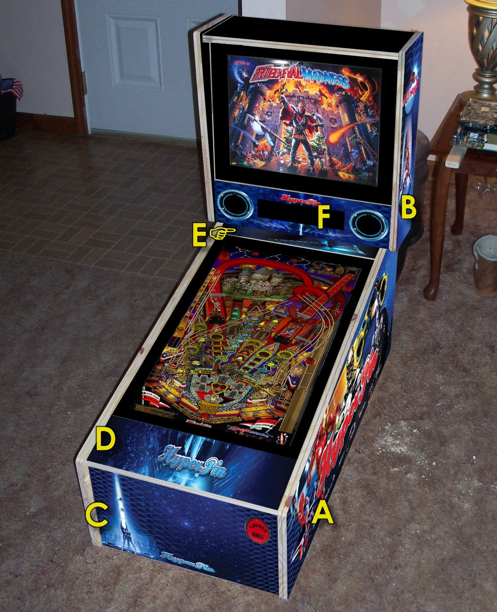

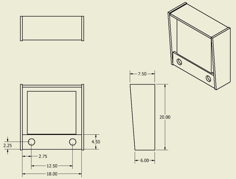

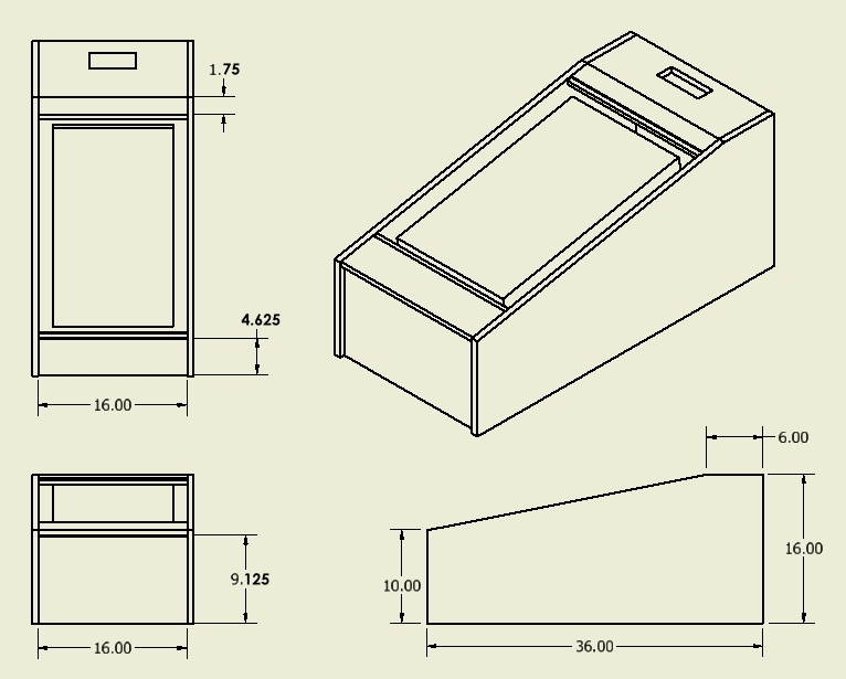

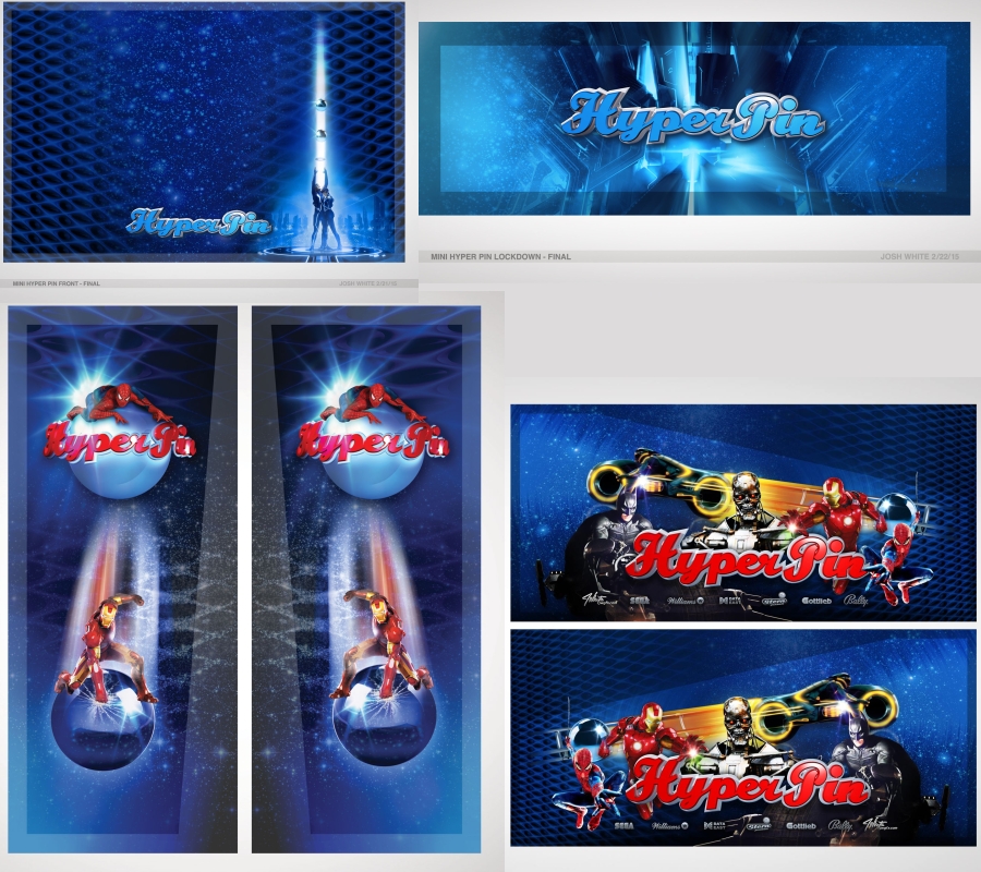

Tredog Posted February 15, 2015 Author Posted February 15, 2015 Artwork dimensions A: [sides x 2] 36" x 15 7/8" (Front 10" tall) (angle starts 6" from back) B: [backglass Sides x 2] 7 1/2" x 20" (Bottom is 6") C: [Front] 16" x 9 1/8" D: [Palm Rest] 16" x 4 5/8" E: [Area under backglass] 16" x 1 3/4" F: [speaker Area] 18" x 4 1/2" ***Speaker centers are 2 3/4" from sides, 2 1/4" from bottom, and 1' 1/2" apart from each other ***Would like the Red HyperPin logo centered (slightly larger) between speakers where the dmd would be and remove the black dmd box (open to other ideas) ***On front, maybe switch tron characters to the right so they are not covered by buttons? Let me know any other information you need! Â Â Â Â
Tredog Posted February 16, 2015 Author Posted February 16, 2015 Final Dimensions for artwork: Â Â Â Â
Tredog Posted February 20, 2015 Author Posted February 20, 2015 Another mock up in Photoshop. If you can't tell, I'm getting excited about finishing this project. ***UPDATED with final graphics for print*** Â Â Â Â

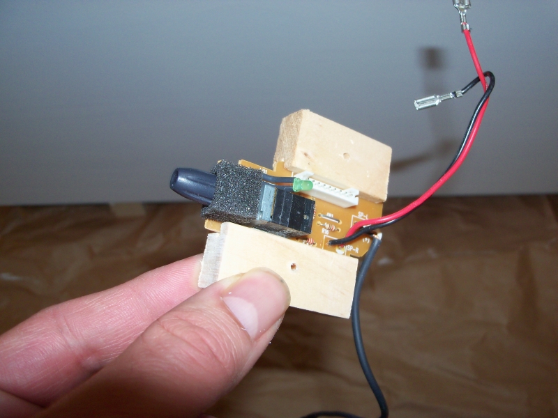

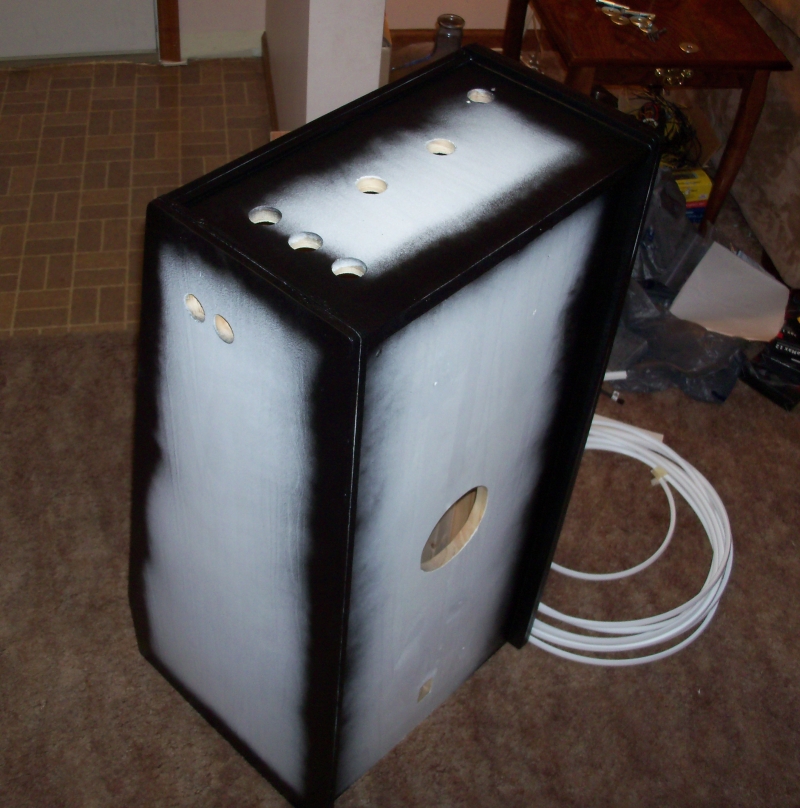

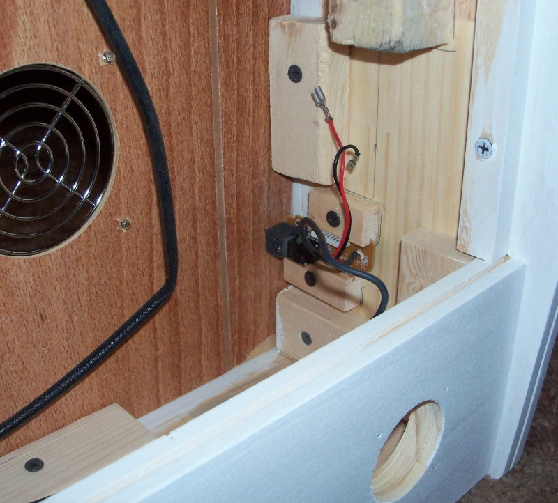

Tredog Posted February 22, 2015 Author Posted February 22, 2015 Got everything primed tonight. Had to come up with a creative way to mount the volume control: Â Â Â Â

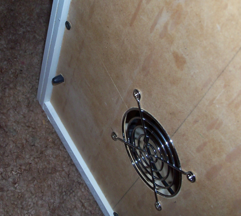

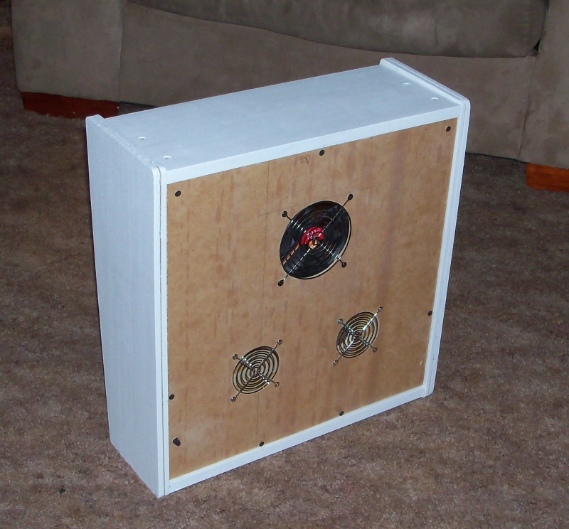

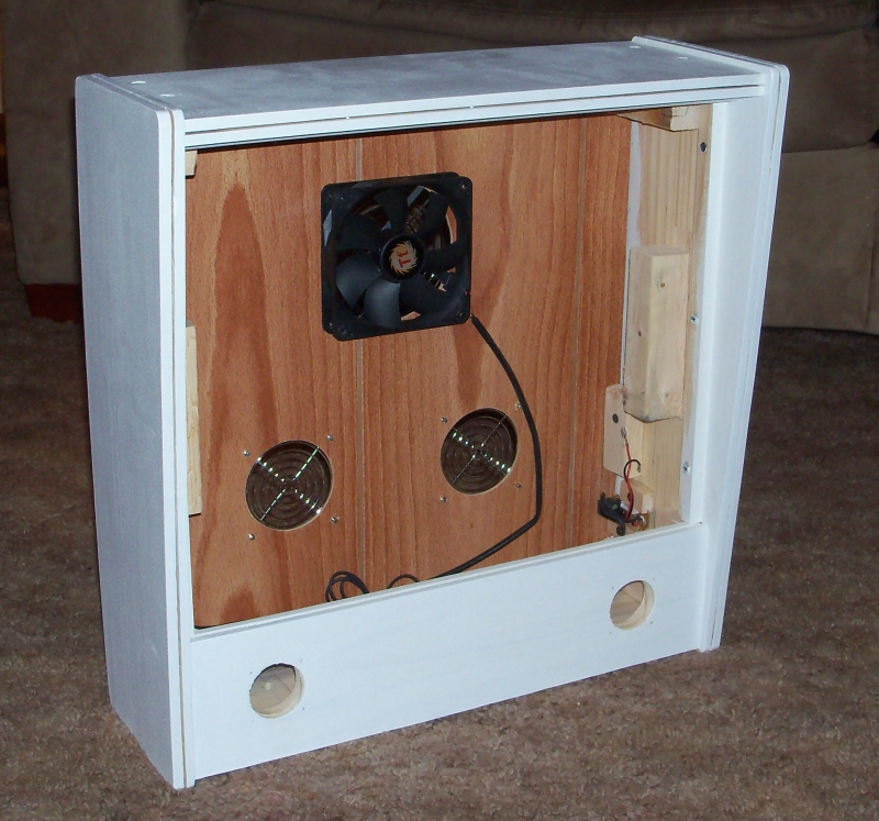

Tredog Posted February 23, 2015 Author Posted February 23, 2015 Small progress tonight... Cut and Mounted panel for the back of the "BackGlass". Test mounted the volume switch, Cut Holes for cooling, and Mounted the exhaust fan. Â Â Â Â
Tredog Posted February 23, 2015 Author Posted February 23, 2015 Josh (DFWArcade) sent the updated graphics for the cabinet: You can find his artwork here: http://www.hyperspin-fe.com/forum/album.php?u=20148 And Brad (Lucian045) for printing services here: http://www.hyperspin-fe.com/forum/showthread.php?14150-Decals-and-Printing-for-your-Hyperpin-Cabinet    Â

Tredog Posted February 28, 2015 Author Posted February 28, 2015 Got the graphics today from DFWArcade and Lucian045 and they look great. Scared to death of the next step    Â

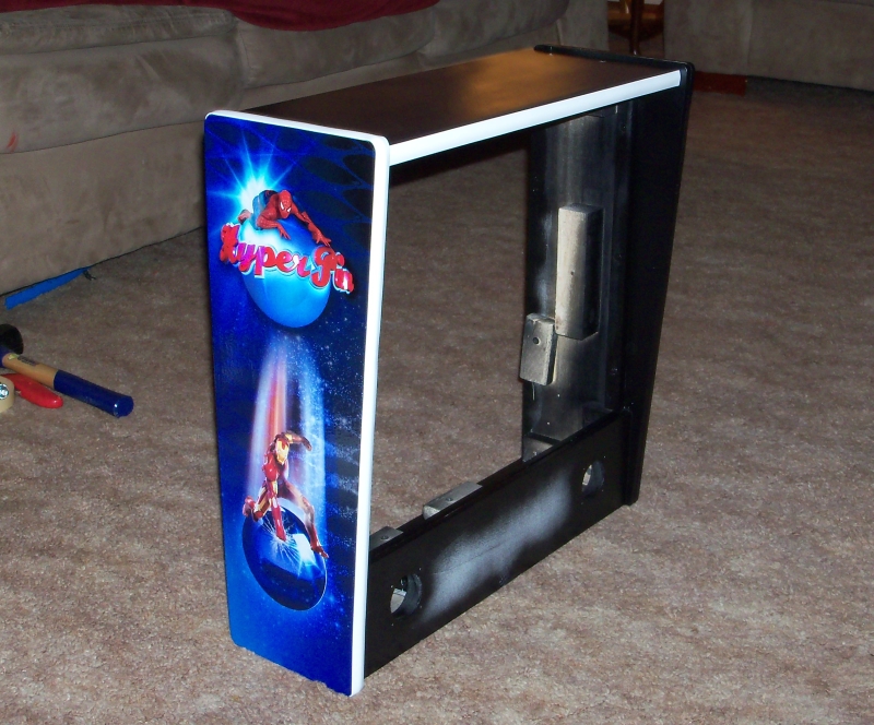

Tredog Posted March 1, 2015 Author Posted March 1, 2015 One Side of the Backglass DONE... Not continuing until I have a new blade for the X-acto. Here are the updated pics: Â Â Â Â

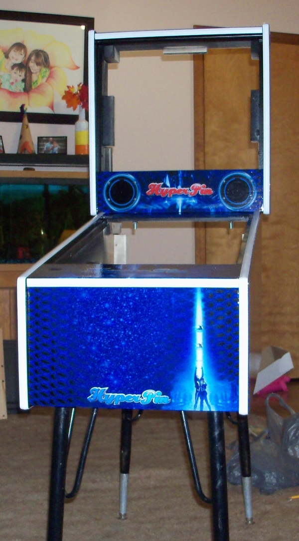

Tredog Posted March 1, 2015 Author Posted March 1, 2015 Took almost my entire Sunday, but I have the Graphics and T-molding on. Thanks again to DFWArcade and Lucian045 for making this thing look BAD ASS! Hope to have the Guts back in by the end of the week... I know my wife can't wait for the piles of tools/pc parts to be removed from the living room. Here are the latest pics: Â Â Â Â
Tredog Posted March 2, 2015 Author Posted March 2, 2015 If I had room, it would be full size all the way. With no basement and not wanting to put one in the garage, this was the best fit. Unfortunately the pictures do not do the mini-pin justice. Will try to get some pics with better lighting... After I do a bit of tinkering with VP and learn the ins/outs, I am sure I will probably build a full size cab and keep it at the shop until I move to a larger home (1yr+ Project). The mini-pin will most likely be mostly Future Pinball tables. Â Â Â Â
