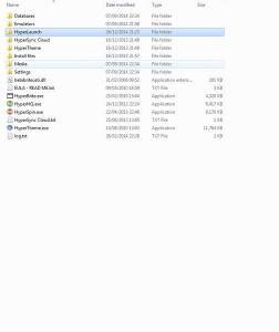

That's odd.i don't appear to have a hyperlaunch folder
That's what I thought. Have you just installed Hyperspin or have you had it for many years? If you new to it then I would suggest you start again or start another install and follow a guide on how to install it correctly.
There is a guide in the main forum.

updated my HS last night and now NOTHING works :(
You say you've HyperSpin, did you reinstall everything or just update since you posted your log?
From your log I can see HyperLaunch is installed in your HyperSpin folder, this is a big no no as they both contain Media folder and maybe some others, HyperLaunch HQ should also be in it's own folder inside HyperLaunch.
So you need HyperLaunch in a folder inside the HyperSpin folder and HyperLaunch HQ in a folder within the HyperLaunch folder.
Did you follow a guide?
You will also need to set the logging level to troubleshooting for your log as the one you posted is level 3 and it needs to be level 10 to give more info. Your log seems to be showing an issue with the file extension.
Also when did you install HyperSpin, recently?
For you troubleshooters out there.
There is now a newish version of HyperSpin (1.3.3) in the downloads section which contains modules and HyperLaunch. The version of HyperSpin which comes in the download is still 1.3.2.
I have a feeling this is what's happening here and is something to be aware of if someone has just installed HS from the downloads section and they have not paid a visit to the HyperLaunch site.
