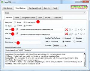

gigapig Posted February 1, 2015 Posted February 1, 2015 Hi Roadrunner. You have HyperHQ filled out correctly as below. You could you Hyperspin log as well.

gigapig Posted March 14, 2015 Posted March 14, 2015 I'm going to have to guess this one Roadrunner. Before this went tits up did mame start straightaway or was there some form of delay and some fancy fade image? Your error "No exe path" is perhaps coming from Hyperspin, so in Hyper HQ have you checked if the paths are set, to both the emulator and Roms. Do that if previously mame started instantly. If however mame started after a fade screen delay, check (also in HyperHQ ) that "Execution " is set to HyperLaunch. Perhaps the settings.ini got screwed up somehow. All I can see in the log you posted is a mismatch in the emu path and rom path. Mame is lower case in one but not the other, but I don't think it matters in that case.
