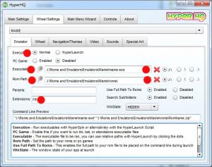

Roadrunner Posted March 17, 2015 Author Posted March 17, 2015 Okay, so I downloaded HL and have it in its own folder. I removed the older versions of HL to a backup file. I set up Mame in HL HQ and can launch games from there. When I go to the HS exe. it launches but when I click on a game I get the message: "Cannot find Hyperlaunch.exe. Does HL have to be dragged into the Hyperspin folder? I thought it stayed in the HyperLaunch folder. Atari 2600 Theme Pack - Now Uploaded! Marvel Exit Screens Jukebox Rock Star Album Themes MAME Widescreen Bezels Pinball FX2 Widescreen Theme Pack Pinball FX2 4x3 Theme Pack Pinball FX3 Themes
gigapig Posted March 17, 2015 Posted March 17, 2015 Okay, so I downloaded HL and have it in its own folder. I removed the older versions of HL to a backup file. I set up Mame in HL HQ and can launch games from there. When I go to the HS exe. it launches but when I click on a game I get the message: "Cannot find Hyperlaunch.exe. Does HL have to be dragged into the Hyperspin folder? I thought it stayed in the HyperLaunch folder. No HyperLaunch should be in it's own folder Within the HyperSpin Folder. The error your getting can be fixed by changing the path to Hyperlaunch in the settings.ini file which can be found in the HyperSpin\Settings folder. It looks something like this. [Main] Menu_Mode=multi Single_Mode_Name=MAME Enable_Exit_Menu=true Enable_Exit=true Exit_Default=yes Exit_Action=exit Version=1.0.0.0 Last_System=Nintendo Wii Hyperlaunch_Path=O:\HyperLaunch\
Roadrunner Posted March 17, 2015 Author Posted March 17, 2015 No HyperLaunch should be in it's own folder Within the HyperSpin Folder.The error your getting can be fixed by changing the path to Hyperlaunch in the settings.ini file which can be found in the HyperSpin\Settings folder. It looks something like this. [Main] Menu_Mode=multi Single_Mode_Name=MAME Enable_Exit_Menu=true Enable_Exit=true Exit_Default=yes Exit_Action=exit Version=1.0.0.0 Last_System=Nintendo Wii Hyperlaunch_Path=O:\HyperLaunch\ Okay, I've done that. I'm able to get Hyperlaunch to work on its own but I'm still getting the same message in HS. Now, when I go to test in HL I get an error: Seems to be unable to find the database for MAME. Also, I'm using an older version of MAME here do I need a different module to run it? Should I use my old module instead? Atari 2600 Theme Pack - Now Uploaded! Marvel Exit Screens Jukebox Rock Star Album Themes MAME Widescreen Bezels Pinball FX2 Widescreen Theme Pack Pinball FX2 4x3 Theme Pack Pinball FX3 Themes
gigapig Posted March 17, 2015 Posted March 17, 2015 You can't use the old modules, but you may need to upgrade mame. Get a new version from Jumpstiles ftp folder and the supporting zip. set it up separately to your original setup. If you can post your Hyperspin & HyperLaunch logs and the settings.ini.

gigapig Posted March 18, 2015 Posted March 18, 2015 Some emulators will work just fine, but you may have trouble with very old versions of mame. Why not just use Hyperspin to launch Mame Roms if you don't want to update it?
Roadrunner Posted March 18, 2015 Author Posted March 18, 2015 Some emulators will work just fine, but you may have trouble with very old versions of mame.Why not just use Hyperspin to launch Mame Roms if you don't want to update it? Hmmm... okay, if I want to go that route how do I do that? Is there a vid on it? Also, would I lose performance by not using hyperlaunch? I guess I'd need all the hide taskbar stuff as well right? I'll try the other emus and see if they work with older modules too. Thanks for all the help Giga. Also, any idea why HL isn't designed to work with older versions of MAME? I guess it would be a whole lot of extra work to support everything? Just curious as to why it isn't designed to work with older modules... As it is now when using the old module, I get an error when testing that says the module doesn't have a "start line" or something like that... Atari 2600 Theme Pack - Now Uploaded! Marvel Exit Screens Jukebox Rock Star Album Themes MAME Widescreen Bezels Pinball FX2 Widescreen Theme Pack Pinball FX2 4x3 Theme Pack Pinball FX3 Themes
gigapig Posted March 18, 2015 Posted March 18, 2015 I've have no idea why the old modules don't work or why older versions of Mame don't work with the newer modules, those are questions for the bods at http://www.rlauncher.com/forum/content.php You ask about losing performance, running Mame via HyperSpin is actually faster that through HyperLaunch, Mame should start instantly with HS. The advantages of using HyperLaunch is the Fade screens and Hyperpause if you like that kind of thing. Here are the settings you need for running Mame through HyperSpin. Fire up Hyper HQ and add the Rom and Emulator path, the extension and the execution which should be set to normal. BTW, I just tested running Mame through HS and then HL. With Hyperspin it was instant, as soon as I hit the button Mame was running. With HyperLaunch I had to wait 10 seconds for BattleZone to start.
