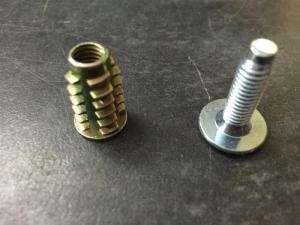

jimmyuk86 Posted February 19, 2015 Posted February 19, 2015 Use threaded inserts. They screw into the wood and have an internal thread, so you can put a machine screw or pan head bolt through it. You can get them as short as 10mm in depth.

Chillimonster Posted February 25, 2015 Posted February 25, 2015 I use threaded inserts (From Screwfix - UK) They are 12mm Depth, but the panel is 12mm, so i 'padded' the reverse with a 3mm MDF spacer to ensure i had enough room. Works a treat!

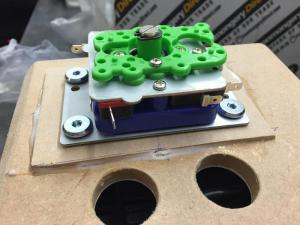

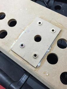

connorsdad Posted February 25, 2015 Posted February 25, 2015 Chisel out your panel so that the joystick plate sits flush with the top of the panel, countersink the bolt heads into the plate and fasten underneath. Lay your artwork and plexiglass over the panel, no screw heads
