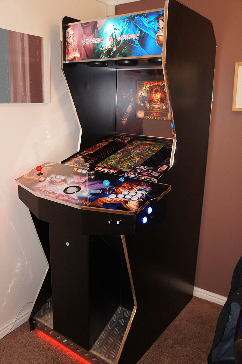

seanr28 Posted December 20, 2013 Posted December 20, 2013 this must be one of the best custom built arcade machines that I have seen to date. Awsome!
gigapig Posted January 5, 2014 Posted January 5, 2014 Thats some real small skirting board you've got in there. Jaw dropping.
connorsdad Posted January 5, 2014 Author Posted January 5, 2014 Small when there's a fn mahoosive arcade in front of it lol. Sent from my SM-N9005 using Tapatalk
seanr28 Posted January 6, 2014 Posted January 6, 2014 simply stunning! Wish I had the same level of dedication as you clearly have:)

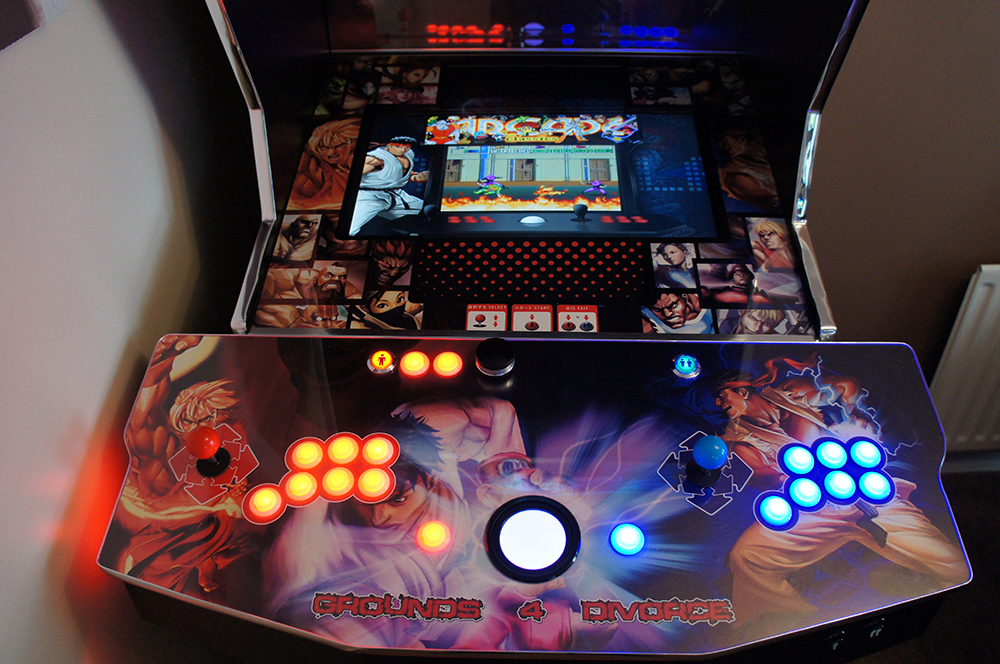

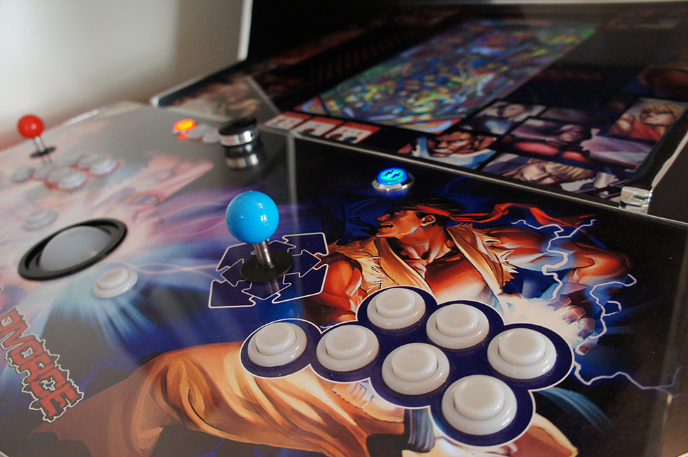

tylert Posted March 11, 2014 Posted March 11, 2014 Could you describe your button assignment on your control panel? It is a fantastic project you have there!!!! Great job! I am trying to finish my control panel design and I love your design and I think would work best for me.
connorsdad Posted March 11, 2014 Author Posted March 11, 2014 tylert said: Could you describe your button assignment on your control panel?It is a fantastic project you have there!!!! Great job! I am trying to finish my control panel design and I love your design and I think would work best for me. Along the top: P1 Start, spinner buttons 1 and 2, spinner, P2 Start. 7 Buttons per player, trackball button 1 and 2 either side of the trackball. Front of control panel has coin buttons for both players on the right hand side. Sides of control panel has; Upper flipper Lower flipper Nudge Sent from my SM-N9005 using Tapatalk

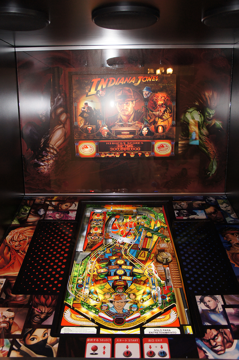

BlueScreenTT Posted March 11, 2014 Posted March 11, 2014 Would love to see some more pics / vids on the inside construction and mechs that makes this cab the kick... build it is how did you get the 2 monitors to work together ? is that a feature in Hyperspin / pinball ?
connorsdad Posted March 11, 2014 Author Posted March 11, 2014 BlueScreenTT said: Would love to see some more pics / vids on the inside construction and mechs that makes this cab the kick... build it is how did you get the 2 monitors to work together ? is that a feature in Hyperspin / pinball ? Auto hot key scripts and lots of questions to fellow forum members here and over at the BYOAC forums. I keep saying it and I will eventually get around to making a video demonstrating the auto rotate and the monitor switching when running gun games.

raywalters Posted June 15, 2014 Posted June 15, 2014 This is stunning, I mean absolutely beautiful. Incredible work went into this. If I may, a couple of questions: 1. Is the rotation automatic based on the game you are playing? Scripted movement? Or do you have to manually flip a switch? 2. Do you have any kind of documentation on your build? Not gonna lie, that rotation is something I want to create to be able to use for pinball games.
connorsdad Posted June 17, 2014 Author Posted June 17, 2014 1. I use different ways in which to tell the screen to rotate. MAME for example checks the selected game against an xml which contains the names of all vertical orientated roms, if the selected game is in that list, it rotates and then rotates back on exit. Next I have some games (eg. PC Games wheel) launching a script before they load (rotate clockwise), and then run a script when they close (rotate anticlockwise) using hyperlaunch3. Finally, for those systems which don't allow you to launch an exe before/after load, I have a script than runs in the background listening for the programs to start/end, eg if program1.exe exists, rotate, when it closes, rotate back, if program2.exe exists, rotate....... etc etc. I use the same idea for switching between monitors when loading gun games. You will need to have multiple instances of the same emulator for certain systems, if I remember correctly, I have 3 instances of Naomi installed, 1 for horizontal games, 1 for vertical and 1 for gun games. 2. When I have the time, hopefully soon, I will add a detailed description regarding the hardware used. At the moment my spare time is taken up with my vpin build. Sent from my SM-N9005 using Tapatalk
