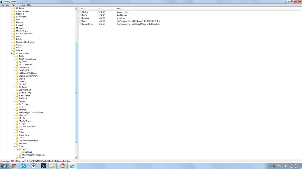

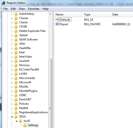

I'm sorry for resurrecting an old thread but I need help running HOD3 in HS. I just started using HS a few months ago and I want to ad some PC shooters. My problem is, I followed everything in this thread but still have problems. I understand that there is a registry change needed to run the main executable without running the launcher. Well, I tried everything and still get the, " You can only start this game from the launcher." It's like the game has no effect on the registry, and even when I change the registry manually, I get the same error. I am using a EU version of the game but I don't think that is the cause. Can you please help?
I have tried your solution as well as others. The problem is, I can't launch HOD3 without the launcher, even if I change the registry manually. I attached a pic of my registry and how it looks. It never changes. Maybe I'm missing something. Once I get the game to load without the launcher, everything is smooth sailin'.
I seem to remember something about the registry entry being picky and not sticking. I "think" I had tried setting it manually but that would not work and I think it had to be set every time right before the game was launched or it would not work which is why I set it in the pre-launch script. I remember getting frustrated with it as well.
Sorry but it was a while ago when I set this, I have it set currently using what I posted.
Try with this registry change:
RegWrite, REG_DWORD, HKEY_LOCAL_MACHINE, SOFTWARE\Wow6432Node\SEGA\hod3\Settings, Played, 1
This worked perfectly! Thank you glstar.
