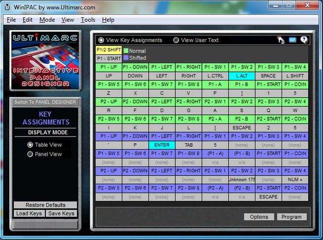

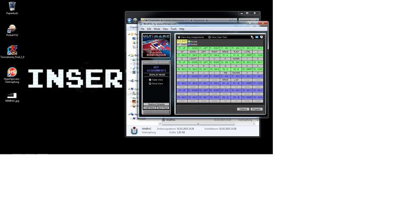

optical Posted February 22, 2015 Author Posted February 22, 2015 heres the screenshot the White side bottoms are on the side of my arcade für pinball games.
bclout Posted February 22, 2015 Posted February 22, 2015 Looks ok to me. Maybe you can switch to the table view and try again to assign the keys?
optical Posted February 22, 2015 Author Posted February 22, 2015 how do I think of that? I choose for example the bottom with "alt.right" and then i press on the keyboard the bottom "Z" and then that's changed? then from "old right" to "Z" become?
bclout Posted February 22, 2015 Posted February 22, 2015 Press "table view" on the left, then assign all your buttons, and press "Program". Your configuration will then upload to the ipac. After that you can test it, the buttons will light up blue on the screen. Tchuss!

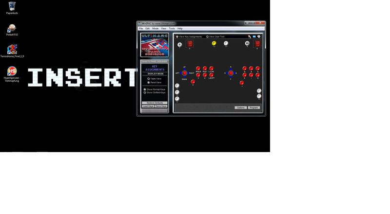

optical Posted February 24, 2015 Author Posted February 24, 2015 ok Folks it worked !! thank u very mutch bclout !! but something happend, now the Action bottoms are mirrored. i tried to Change the bottoms to unmirror but didnt work. but i can Chance the cableing on the Panel if nothing else helps
bclout Posted February 24, 2015 Posted February 24, 2015 Not sure what you mean?? Did you check with the ipac wire drawing from their website? Or just re-program the buttons again in winipac. P1 = player 1. Check also the control panel view again if that is still correct (instead of table view). Oder schicke mich eine pm auf Deutsch.
optical Posted February 24, 2015 Author Posted February 24, 2015 Let me explain: Player 1: there are the action bottoms 1-7 like you can see on my screenshot. When i m pressing the first action bottom (upper,left bottom) then the bottom is lighting up from action bottom 3 Pressing action bottom 3, bottom 1 is lighting up. The bottom line down (action bottom 4,5,6) same problem. Player 2 - exact the same happening like by player 1. In german for bclout: wenn ich die erste action taste drücke leuchtet die taste 3 auf. Drück ich taste 3 leuchtet die taste 1 auf. Die knöpfe darunter das gleiche. Drücke ich knopf vier leichtet nr 6. Die knöpfe in der mitte gehn natürlich. Bei spieler 2 das gleiche. Ich könnte ja jetzt entweder grad die kabel tauschen. Oder bei winipac beim design grad die knöpfe verschieben, so das es stimmt. Oder ich las es einfach so wie es ist weil im emulator kann ich ja eh so einstellen die knöpfe wie ich mag. Was meinst du?
bclout Posted February 24, 2015 Posted February 24, 2015 Also, wenn ich das drat diagram folge vom ipac dann hat ich alles correct. So ich denke dass deine draht nicht richtig angeschlossen ist. Kein problem, aber es wird nicht einfach. Hyperspin, mame und mednafen emulatoren sind einfach an zu passen, aber anderen vieliecht schwer. Jetzt denke ich auch an meine tasten zu andern. Manche emulatoren hatten scchweirigkeiten met alt, ctrl oder enter oder 1,2,3 etc. Aber muss noch schauen welche die beste tasten sind die wirken fur alle emulatoren. Du musst immer denken an die folgenreihe und was genau passiert: knopf 1 zu ipac macht X zu emulator macht links mit joystick ins game etc. Ich werde verruckt :-/
