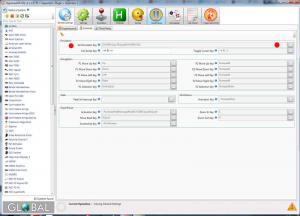

gigapig Posted February 23, 2015 Posted February 23, 2015 Hi Gavin Have you tried setting the exit emulator key/s in HLHQ, it should work with most emulators.

gigapig Posted February 26, 2015 Posted February 26, 2015 That module info in your last post seems to suggest that your set up is rather old and not RocketLauncher, so I won't be able to help much And as you still haven't told us the emulator version I've had to take a guess and pulled this info from a module. You can remove Esc as a key to change fullscreen mode in the Settings->Keyboard Shortcuts, change CPU State to Game Playing (fullscreen) then Options->Full Screen and remove Esc from Current Keys
