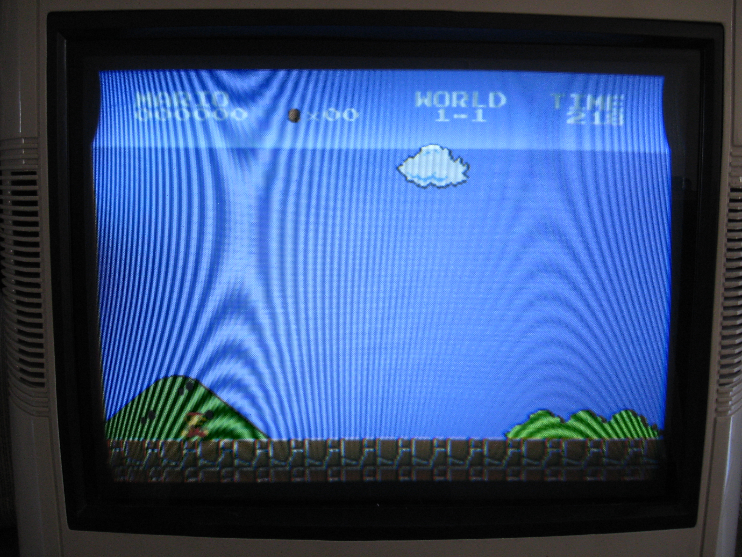

JayC Posted March 13, 2015 Author Posted March 13, 2015 Yey!!! I got one of the computers down to 640 x 480, this seems to be the highest it'l go. Windows looks awful, but when running Super Mario Bros. on RetroArch Nestopia it looks pretty nice. The only problem now is the warped bit in the top of the screen...clearly visible when there's a uniform background at least. Is there anything I can do about that or will I just have to live with it? Here's a pic of what I mean:
Anpanman Posted March 13, 2015 Posted March 13, 2015 try adjusting the horizontal hold. if that doesn't help, the chassis might need a recap.
JayC Posted March 13, 2015 Author Posted March 13, 2015 Tried adjusting it...doesn't help I'm afraid. A recap you say...could that help? What would that set me back?
Anpanman Posted March 13, 2015 Posted March 13, 2015 a few cents to a few dollars depending on the cap quality and your source. You are going to need some soldering experience as well. You really need to find more info on the chassis first.

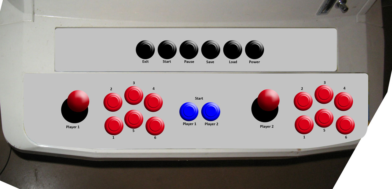

JayC Posted March 14, 2015 Author Posted March 14, 2015 I'm no stranger to soldering...but the discharging is a little unnerving. All the numbers I've found on the chassis I posted earlier, tried googling for them but only one of them gave any results. Any idea where the numbers could be? Here are all the numbers I found once more: GXN 6253 SP054U 70609? SCD-29411VX2V MIR-J 070613 DIF2920V2VB Started playing with the control panel layout...how does this look? I added save load buttons for console games. Is this a functional layout?
JayC Posted March 14, 2015 Author Posted March 14, 2015 Oh...I forgot coin buttons...Do I need 2 coin buttons? Maybe I would just use a shift button setup for save load buttons and put the coin buttons on the top row?

Anpanman Posted March 15, 2015 Posted March 15, 2015 Arcadevga isnt going to help yuo with that screen wobble. It's either caps or the HOT or something else. as for the marquee area. it may be more simple to just get a custom piece of plexi cut to something reasonably similar and mount it. Lots of Candy cabs did not have full-fledged marquee areas. They just had a sheet of plexi that allowed the marquee to be held up to show the game. sort of like this

Anpanman Posted March 22, 2015 Posted March 22, 2015 identifying the monitor is the first major step to fixing it. I'd suggest getting the chassis recapped and do the fix mentioned in the wiki or perhaps look for someone on arcadeotaku that can do all of the mods for you. Wei-ya stuff isn't the best but unfortunately its some of the most common new CRT stuff on the market today.
