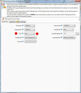

I assume your tweaking the HLSL settings? You do have them switched on in both the ini file and in HyperLaunch HQ correct?

  Beardedgamer23 said:
I'm directly adding the tweeks in the mame ini file after using the slider to know what settings I want to apply in the ini file just when I exit out boot up hyperspin and launch mame not settings have been saved even when I exit and check the ini file again it's still as I edited
As gig and I said above make sure you have hlsl turned on in the Mame global module or you will never see them from Hyperlaunch or Hyperspin but will from launching Mame or mameuifx gui independently from the HS / HL progs
