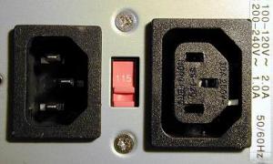

Although depending on your power supply you might be able to use a pass through cable so that your monitor turns on when your pc turns on (see below).
[ATTACH=CONFIG]52195[/ATTACH]
