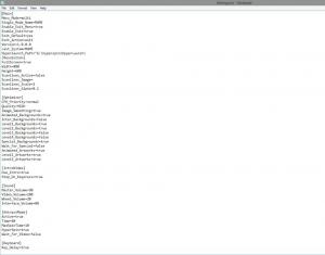

methos01 Posted March 19, 2015 Posted March 19, 2015 Hi everyone i'm new to this..been reading up a lot on the forum. I ran into a little bit of a snag. I can't seem to launch any games from Hyperspin. I believe the reason is hyperspin is launching the old hyperlauncher not the new one .V3 that I installed in its own folder. I did edit the path in the settings folder but maybe I missed something. Anyone have any idea what I did wrong? I will attach a screenshot of my settings file and my log file http://pastebin.com/hcn6qNFw
gigapig Posted March 19, 2015 Posted March 19, 2015 Hi Methos01, welcome to the forum. The path you changed looks good, apart from HyperSpin not being capitalised (hyperspin. G:\hyperspin\HyperLaunch.exe) Other than that I can't see a problem, perhaps post your HyperLaunch log set to troubleshooting. Cheers
rfancella Posted March 19, 2015 Posted March 19, 2015 Hi, It might also be, are you using the newest HyperSpin executable? I believe the old HyperSpin does not use that variable. And looks for HyperLaunch.exe in it's own directory. Thanks, Ron Code Monkey and all around Command Line geek!If you like what someone has said or done for you, be sure and 'Thank' them. And if they changed your life, send them a Beer!
methos01 Posted March 19, 2015 Author Posted March 19, 2015 rfancella said: Hi,It might also be, are you using the newest HyperSpin executable? I believe the old HyperSpin does not use that variable. And looks for HyperLaunch.exe in it's own directory. Thanks, Ron The version I have is 1.3.2.0 is that the latest version? I tried renaming the old version of hyperlauncher and hyperspin gave me an error saying he could not find a launcher. Thanks for helping Quote Hi Methos01, welcome to the forum.The path you changed looks good, apart from HyperSpin not being capitalised (hyperspin. G:\hyperspin\HyperLaunch.exe) Other than that I can't see a problem, perhaps post your HyperLaunch log set to troubleshooting. Cheers I was thinking that could be a problem but don't understand why it would be. I could change the folder name but I'm worried I'm gonna mess everything else up Thank you
