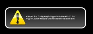

OneLgGrsy Posted March 22, 2015 Posted March 22, 2015 It's been a few years since I had my machine up and running (not much me time with a new little one running rampant). But I decided a couple of months ago to go with a new build with updated software (so this is a new machine totally new build - not trying to just update the old one). I followed to the letter on the build guide - http://www.hyperspin-fe.com/forum/showthread.php?29481-How-to-install-HyperSpin&p=279515&viewfull=1#post279515 installed MAME, have all my ROMS and video, etc. have been in MAME and am able to play games, but when I launch Hyperspin I can't actually get it to launch the games. The games all show up, the videos play for each as I scroll from one to the next, but the title of the game immediately goes blank. When I hit enter it gives me an error: I went to the folder and found the file (it was labeled as example so I corrected it), but it still gives me the same error. Has anyone seen this before? Thanks, OneLg
gigapig Posted March 22, 2015 Posted March 22, 2015 So the path is correct and you have obviously renamed the dxwnd (Example).ini to just dxwnd.ini? Perhaps post your HyperLaunch log set to troubleshooting.

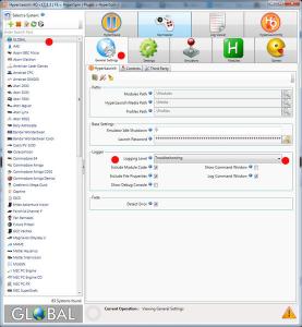

gigapig Posted March 23, 2015 Posted March 23, 2015 jeremy0203 said: Wasn't that issue fixed in a newer release of HLHQ/RL? That will depend on when OneLgGrsy downloaded his version of HyperRocketLauncher. You can find the setting for setting the logging level here. The log is in the HyperLaunch folder, please paste it all including the code tags or put it on pastebin.

ghutch92 Posted March 23, 2015 Posted March 23, 2015 Make sure you can see the extension: Known Extensions Are Set to Show Are you sure you didn't rename it "dxwnd.ini.ini"? How to Install HyperSpin and more RocketLauncher HyperSpin Startup Script
OneLgGrsy Posted March 24, 2015 Author Posted March 24, 2015 That was exactly my issue... thank you. Would you happen to know of a way to get it to not ask me if I want to allow Fontreg to run before I play each time? I thought maybe going in and changing the properties to "run as admin" would do it, but doesn't seem to make a difference. Thanks again. edit: it is pointing me to the Hyperlaunch\Modules folder. there is a MAME folder with a MAME (example) config file... do I need to switch that to just "MAME" without the example?
