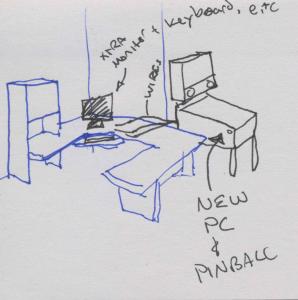

teedoe Posted April 15, 2015 Posted April 15, 2015 I am a long time lurker here and wanting to start a build but I have a dilemma. I will keep it short. I have an old PC that I need to upgrade for my personal workstation (used infrequently): Intel Core 2 Duo, old graphics card (raedon 4500 or something), 4 GB RAM (max is 8), Win 7 - 64bit. Even after all the possible upgrades to this (SSD, Graphics Card, RAM), I don't think it will perform well enough for digital pinball machine. Let me know if I am wrong, but pretty sure it just won't cut it. So my idea is to build a PC to perform as both the digital pinball machine and the workstation. Basically running 5 monitors, 3 for the pin and 2 for the workstation, the pin would be near my desk and keyboard, mouse, monitors and USB cords could easily reach. Everything else would be housed in the pin cabinet. Would this solution work? Or will it be such a pain in the ass to achieve and not really save me any money on the bigger PC build compared to two dedicated pc machines? All thoughts are appreciated. Thanks. Here is a doodle of the idea.
dark13 Posted April 15, 2015 Posted April 15, 2015 Upgrading the videocards should work for pinball arcade and pinballFX (i'm running them on a p4 3ghz on my htpc), future pinball with zed physic need a beefier cpu. The main problem is you can't run 5 monitor with a single videocard, and honestly I don't know how easier will be screen assignment using 2 videocards. In terms of windows using autologging one user for pinball and ctrl+canc+alt on pc keyboard to disconnect and log another user is possible. You can assign user-dependant shell in xp and seven. I think it may be possible but a lot of troubleshooting would be involved... Automatizing infopanels creation from .csv files for HTPCs themes (look at infopanel tutorial.zip on the ftp in dark13 folder) PNGs to SWFs automatized flash scripts Hyperspin Wheelset automatized template (photoshop's variables + batch) Aeon nox 4.13 W.I.P. hyperspin skin
Tredog Posted April 17, 2015 Posted April 17, 2015 First off, Nice IDEA... Depending on your settings, your current video card may get you by on lower graphic settings. However, If you did build a new PC with 5 Monitors, I would Duplicate Monitor 1 (MAIN) as your play field and main PC Monitor on desk. Duplicate Monitor 2 as Back Glass and 2nd Monitor on desk. Then Monitor 3 could be a dedicated DMD monitor for pinball only. This would be the most practical setup, using a splitter cable on Monitor 1 and 2 to split the signal (Just make sure your monitors support the same resolution) your pc would not even be aware of the extra 2 monitors. You could go from 2 monitor PC Setup, flip a switch turning on the 3 monitors on your cab, fire up pinballx/hyperpin, and be instantly transformed to pinball mode. Just flip off the desk monitors... My 2 Cents...
