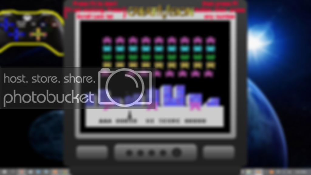

added the info regarding how to start a game to my bezel
There's a mistake on the bezel.
"Press F3" -> correct, that lets the console enter in "Select game mode".
"Press P1" -> wrong! If you press P1, you will change the game mode from 1 to 2. The 2nd game mode is usually for 2 players. So I would change into "select game with any fire buttons"
"Press any number" -> wrong! It's not a matter of "pressing any number". Number 1 won't work! :)
You can press any key on the keyboard BUT the ones on the leftmost and rightmost side of a CreatiVision keyboard. This means that you can't use 1, CONTROL, SHIFT and DELETE (or back-tab) on the left side + SPACE, RETURN, RIGHT-TAB and EQUALS on the right side.
The CONTROL, SHIFT, SPACE and EQUALS keys are mapped in the same way as the joystick buttons, so they will obviously work like "change game mode". The remaining keys are disabled and won't let you start a game
So I suggest you to change your bezel into "press any LETTER KEY" as opposed to "any number". :)
