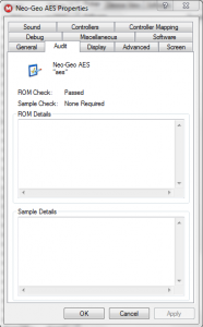

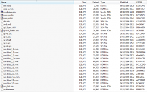

Dunk3000 Posted June 6, 2015 Posted June 6, 2015 Ok, so I have attached an image of the contents of my aes.zip file. All I can suggest is looking at yours and search for any files you do not have and replacing (check CRC values). This has worked for every version of mess I have had is still passing audit for latest version (0.162) From memory I think I built this myself so it may be that some files are not needed but I can guarantee if you have all these files it will work - infact I'm gonna post an image of the audit check too so you know it is possible. I didn't do anything special to get this (just google) so the files are out there

deano71 Posted June 6, 2015 Posted June 6, 2015 Ok, so I have attached an image of the contents of my aes.zip file. All I can suggest is looking at yours and search for any files you do not have and replacing (check CRC values). This has worked for every version of mess I have had is still passing audit for latest version (0.162) From memory I think I built this myself so it may be that some files are not needed but I can guarantee if you have all these files it will work - infact I'm gonna post an image of the audit check too so you know it is possible. I didn't do anything special to get this (just google) so the files are out there Thanks I will continue to dig!
