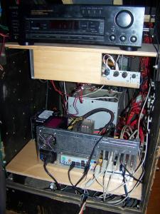

Mine is an old Taito Cab.  I gutted it and mounted aluminum angle on the sides near the bottom.  Cut a 3/4" plywood shelf and mounted part of the case (I cut it down) and HDD bay on the ply, that way I can slide it out to work on it.
post-10936-0-27949900-1429798729_thumb.j
I also added a shelf above for the stereo and mounted a subwoofer amp right below it.  There is also a 12" sub mounted in the base.  ;)

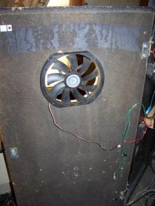

If you leave the side off, just mount a big fan on the back door.   ;)
post-10936-0-42678500-1429802941_thumb.j
I used to have a complete case in mine.  But even with fans, it was just blowing around hot air.  So I cut up the case and only left the bottom and back plane.  The fan blows out to vent any hot air and I have a couple vents in the bottom to draw in cool air.

Nice!  How big are those fans?
I am just using one.  It seems to be enough, even with the two audio amps in the cab.
http://www.watercoolinguk.co.uk/p/Coolermaster-200mm-Chasis-Fan-A23030-10CB-3DN-L1_1247.html
