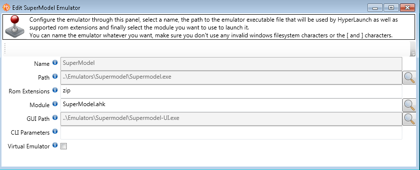

dougan78 Posted May 3, 2015 Posted May 3, 2015 Maybe this will help here is my Supermodel Settings from global settings --> Emulators in hyperlaunchhq I don't think you can launch this emulator from hyperspin via putting emulator in hyperhq because hyperlaunch requires both the gui and emulator executable files so it will require hyperlaunch to get working I believe. Good luck.

dougan78 Posted May 10, 2015 Posted May 10, 2015 What version are you using because I am still on 3.1.0.5 or something of hyperlaunch and that won't work if you updated to rocketlauncher 1.0 I am sure.
