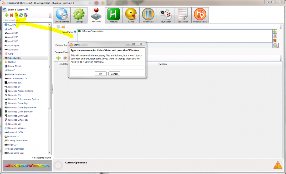

pyrater Posted April 27, 2015 Posted April 27, 2015 Can someone please help, since the new forums all the google searches point to dead links making research a PITA. Please watch the video below for an idea of whats going on. (Same problem for Adventure Vision and all Mess emulated games). Thank you, Im sure its a simple fix..... https://www.youtube.com/watch?v=24fPmBvn6l4&feature=youtu.be
32assassin Posted April 27, 2015 Posted April 27, 2015 rename your "Arcadia 2001" to the RocketlauncherUI official name "Emerson Arcadia 2001" Open RocketlauncherUI go to your RocketlauncherUI folder inside the RocketlauncherUI folder look for --> Media --> icons go back to RocketlauncherUI you see all your systems that don't have an icon next to them. Rename them to their official names. 1. find the official name in the icons folder. 2. select the system 3. click on rename sytem. 4. copy and past the official name from the icon you find in the icons folder. 5. when renamed you should have an icon next to your system. you will be able to use a Global emulator. you can delete your system emulator you created.
