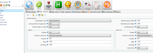

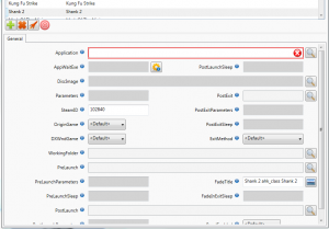

Module settings for the game has nothing except the SteamID (102840) and the FadeTitle:

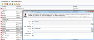

This is my module. I have made no changes to it:
Here is my Global Emulator settings for it:
Here are my Fade General and Fade Progress global settings. I doubt you need to match mine:

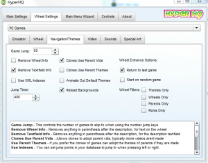

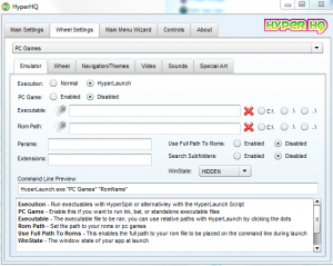

My HyperHQ settings are basically blank:

METALZOIC i want to thank you for all your help. up to now its working the games that are not working initially they work after setting the appwaitexe in hq. thanks again! i had module 2.1.1 i grabbed one that is even older 2.0.5 and that worked. somehow my module was bad.
now just need to start each game once so steam does the install thingy it always do. then to setup controls wich i have no idea how ill do using the xin-mo usb controller on the cab.
Good to hear you're getting it working. It frustrated the hell out of me too when I was first figuring it out.
Which games have you found need to use AppWait? Just curious...

not a father yet but thanks! and same to you. well shank2 made me have to set the appwaitexe, ARES aswell. have not needed to set anymore yet. the rest have been all working so far. with each game i launch im finding it so confusing on how im going to even start working with controls.
