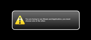

all PC games work perfect, but the Steam Game gives me a error "you are trying to use Steam and Application, you must choose one or the other."
this is the only place where I found anything specific for Steam. The Game SteamID
If the game is not a steam game then you need to clear out the option of "steam ID" under the game settings in your HL. This should resolve that problem. Leave steam ID empty for non steam games.

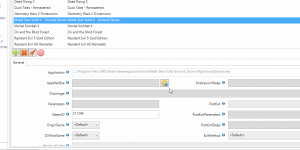

In the PC Games Hyperlaunch module at the bottom did you put the games SteamID and also put the path to the .exe above that?
If so that's the problem. You ONLY put the SteamID for steam games. For non-Steam PC games you only put the path to the .exe.
that was the problem. I did both things :o

edit, i have managed to get working my older non steam games by simply re adding their .exe directory in hyperlaunch hq. but i still cannot get the steam games working. i have the name.exe set in appwaitexe. and have the correct steam ID set in steam id. and still. and if i add the game directory under "application" i get an error that im trying to run steam plus another aplication i need to choose only one.
Did you follow the steps I poste din post #7?
For Steam games you (usually) leave appwaitexe blank. You do not add a path to the exe. You just put the Steam ID number and for some (many?) games you set up the fadeexit info.
Then obviously your names all have to match exactly. You also have to add your Steam games to the Steam.ini under Modules\PCLauncher (Steam ID/Matching name/name of .exe in the steam folder).
