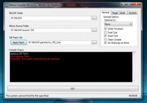

sreisig1 Posted October 27, 2014 Posted October 27, 2014 Does it matter that I used a different drive other than C, even though my locations are correct? Getting an error applying patch. "Error applying patch. PatchDiff(): The system cannot find the file specified"
klizine Posted October 27, 2014 Posted October 27, 2014 No, it doesn't matter what the drive letter is. However it needs to know where to look. That error means the paths aren't correct. just double check... use the buttons on the right of where the path is to manually find them.

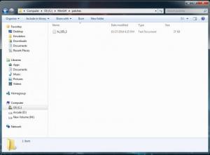

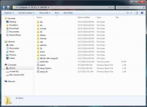

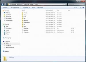

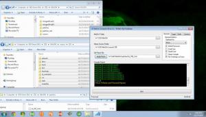

klizine Posted October 28, 2014 Posted October 28, 2014 The paths are correct can you take a screenshot like below?
sreisig1 Posted October 28, 2014 Posted October 28, 2014 MinGW location: Source location: Patches location:
klizine Posted October 28, 2014 Posted October 28, 2014 but in the screenshots above all of the locations are pointing to your C: Drive. But in the tool you were pointing them to M. In the MAME Compiler you need to point them to the correct locations, so for you it should be C:\MinGW not M:\MinGW etc.
sreisig1 Posted October 28, 2014 Posted October 28, 2014 but in the screenshots above all of the locations are pointing to your C: Drive. But in the tool you were pointing them to M. In the MAME Compiler you need to point them to the correct locations, so for you it should be C:\MinGW not M:\MinGW etc. Sorry. The original shot with the m drive is before I tried moving everything to the c drive. Same issues with everything being c drive.
klizine Posted October 28, 2014 Posted October 28, 2014 The only thing I see looking odd is your MinGW folder. I only have a folder called mingw64-w64, with sub folders below that. Try deleting and re-installing mingw-mame-w64-20140905.exe
sreisig1 Posted October 28, 2014 Posted October 28, 2014 The only thing I see looking odd is your MinGW folder. I only have a folder called mingw64-w64, with sub folders below that. Try deleting and re-installing mingw-mame-w64-20140905.exe That worked. So far have all green after hitting apply. On to the next step.
