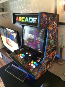

aardal1 Posted May 8, 2015 Posted May 8, 2015 Hello Since the Escape-key is widely used in MS-DOS games for different menus etc, i want to choose another way to exit the emulator (Dos box via Dfend (Dfend is my choosen emulator)) The preset in hyperlaunch uses 1500 ms as the "exit emulator key wait" and the "exit emulator button" is global (esc) Hyperspin still exit MS-DOS on a single esc-button push, not by holding it down as i tought this configuration would do... Do i need to setup a multiple button combo, Esc + Enter maybe? How to i do this? I dont really understand the correct way to edit the button input in the "exit emulator button" field.... I am almost complete with my bartop build and its turning out great! Have a nice weekend!
