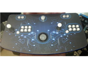

jonnieboyrevel Posted May 10, 2015 Posted May 10, 2015 Finally getting there with the CP. Thought I'd share. Be gentle, this is the first full size panel I've tried to make...
Metalzoic Posted May 10, 2015 Posted May 10, 2015 Very nice. I'll be rebuilding my CP soon too. Not looking forward to it (or to the ridiculous cost). What did you do for your artwork? Who printed it and what material? It looks like direct artwork and not under lexan or anything? EDIT: Are those RGB buttons? What brand and what controller did you go with?
jonnieboyrevel Posted May 10, 2015 Author Posted May 10, 2015 Hi Metalzoic I bought some vector images from vectorstock. Basically some different circuit board vectors and played about with them in Photoshop (emphasis on the played, I only know what about 3 of the functions in Photoshop actually does...) Printing wise it's a little bit odd. I got my printing done by a company called pixartprinting. I had one printed as a glossy poster and one on vinyl. The intention was to use the poster to see if it looked ok and then use the vinyl in the final panel. However, I managed to drill a hole through my vinyl version... In the end I stuck the poster to some thin card and used that. It is under clear acrylic so it looks nice and shiny in real life. I can't really tell the difference from the vinyl now it's under the plastic. Yes the buttons are RGB. The joystick tops and trackball are too. I got all of mine from Ultimarc and have been very happy with them. I've adjusted the brightness of all the colours in LEDBlinky so that they only just glow rather than shine out, it seemed more in keeping with the circuit board look of the panel.
Metalzoic Posted May 10, 2015 Posted May 10, 2015 Nice. Are they Ultralux buttons with the chrome rings? That's what I'm rebuilding mine with. Haven't decided on art yet, but something that matches the cab art.
jonnieboyrevel Posted May 10, 2015 Author Posted May 10, 2015 They are the Ultralux but I went for the ones without the chrome. I wanted the whole button to glow, like it's a part of the circuit board. I'm very impressed with Ultimarc, they have always replied very quickly to any queries I've had.
