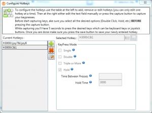

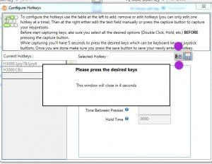

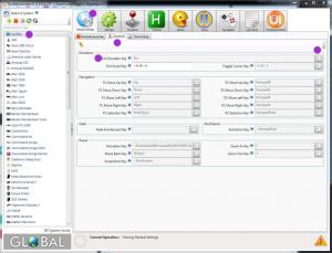

gigapig Posted May 12, 2015 Posted May 12, 2015 If you want to keep esc as your exit key (not recommended) you need to do what Ninja said and change the Pause key in PPSSPP which is "Keyboard esc" by default. Fire up the emulator and click Settings>Controls and then Control Mapping. Scroll down until you see "Pause" and click the "X" next to "kbd.esc" that will remove that key binding. You now have to add a different key for pause so click the "+" next to pause and add the key of your choice. Alternatively set up a unique exit emulator key from within RocketLauncher UI. Go to Global>General Settings>Controls. Under Emulators click the keyboard key button at the end of the Exit Emulator Key section . Now decide what key or key combo you wish to use. In my example I have chosen to hold for 3 seconds the start and back buttons on my 360 controller and also for when I am using my key board the "C" and "1" keys also held down for 3 seconds. You can choose you own of coarse. Press the green "+" button then select your Key Press mode from the choices. Hover over the information buttons for more details of each mode. You must choose these actions first and once selected click the capture button. Once you have chosen your keys click the save icon Now you can continue to add other keys or combos if required, otherwise you can close and test.
