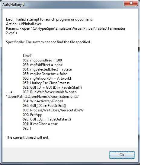

I want to add Visual Pinball (version 9.9.1) and run in in HyperLaunch.  As I said, I am new, so maybe this isn't possible.  However, I can get everything working in HyperLaunch HQ, games are seen and the emulator runs from the module menu.  However, when I try and test from HyperLaunch, I get the attached error:
I am pretty sure it is my module (pasted below).  The provided modules didn't work.  I tried to simplify it to see if I could get it to at least launch, but I believe I am still wrong.  Please help if you are able to.  Thanks!
GUI_ID := GUI_ID := FadeInStart()
RunWait, %executable% open "%romPath%%romName%%romExtension%" ;  -play
WinActivate, vPinball
GUI_ID2 := FadeInExit()
Process, WaitClose, %executable%
ExitApp

when it comes to launching games its more important to mention if you are using Hyperluanch 2 or Rocketlauncher.
when you load a game in hyperspin,  Hyprspin calls Hyperluanch or Rocketlauncher to do the loading.
I can't give you any advice on Hyperlaunch 2, I have VP fully running in with Rocketlauncher.
the module works fine.
the only requirement is that you need to open Visual Pinball and disable the Esc key.
Preferences --> keys
depending on your system you may or may not need to do some module specific settings
again; this settings are dependent on your PC.  You may be able to leave them all in default or need to change them all.
Thank you very much 32assassin!  Your response was a call to action for me and I am hoping I am on the correct path now.  I am just a little slow because I am working a 9-5 while trying to do this.
First, I didn't know that HyperLaunch and RocketLauncher were the same tool, except RocketLauncher is the new version.   I was on HyperLaunch (version 3.1.0.4), so I am installing RocketLauncher 1.0 and going through all the configuration issues.  Once it is working properly, I will follow the rest of your advice once that works.  I am sure it will get things working properly.

IT WORKS!!!
Thanks again so much 32assassin.  I had already done the button config while playing around in Visual Pinball, so it worked like a charm once I got RocketLauncher configured properly.  All the other emulators took just a little bit of config and they were working well also.
