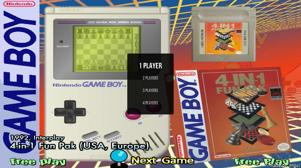

mugenmike911 Posted May 29, 2015 Posted May 29, 2015 Hello im trying to disable the multiplayer menu when selecting a game boy game. Im always prompt to select 1-4 players before launching game... any ideas [sIGPIC][/sIGPIC]

mugenmike911 Posted May 29, 2015 Author Posted May 29, 2015 Yeah i was surprised too... ive updated to the latest hyperspin and rocketlauncher... before updating i had never seen the multiplayer menu pop up... im using bgb1.4.5 for gameboy.. i also tried disabling the multiplayer menu individually for roms on module settings but no good.. the menu still pops out..any ideas [sIGPIC][/sIGPIC]
mugenmike911 Posted May 29, 2015 Author Posted May 29, 2015 this is what im talking about [sIGPIC][/sIGPIC]
mugenmike911 Posted May 29, 2015 Author Posted May 29, 2015 yeah bgb, i like it because its the closest emulator that sounds and looks like the original gb but yeah still haven't found a way to get rid of the menu [sIGPIC][/sIGPIC]
gigapig Posted May 29, 2015 Posted May 29, 2015 I use RetroArch but have set this up to see if I can help. I managed to sort it but had to read the module to understand what is going on. You should report it at the RL site because it should have an option to disable it. So what I've done is created an ini file which goes in the module folder with the correct "stuff" in it. It set to fullscreen=false at the moment but you can change that. Let me know if you report it or not. Bgb.zip

mugenmike911 Posted May 29, 2015 Author Posted May 29, 2015 i just finished testing it and i works.... thanks once again ive learned something great today ... ill head over and report it edit: already reported it [sIGPIC][/sIGPIC]
