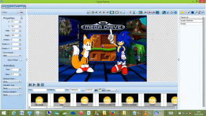

thatman84 Posted July 1, 2016 Author Posted July 1, 2016 So you will have to wait for his stuff to come to the Premium Downloads section but if you already have the mp4 videos you can do it. Apparently this way is not as good quality as the swf background Theme BUT to my untrained eye it looks perfect still Simple answer Use the theme.xml i have now attached to the 1st post. (should be universal just change the name to suit whichever system required) Place the mp4 Video in you main menu or system video folder (Media/Main Menu/Videos or Media/SYSTEMNAME/Videos) named as normal the same as the system/game And that is it Long Answer Change the mp4 extention to flv Open hypertheme and start new theme add a background (any background its only required for saving in hypertheme) add the cinematic video to the theme set Force Aspect to "Both" set width to 1024 set Height to 768 SAVE the theme Find the Theme and extract it delete the background.png zip it back up and place it in the correct folder change the video extention back to mp4 and place that in the correct folder done (im tired so hope i did not miss a step ) Official Hyperspin Tutorials Playlist HS Android Overview & Install HS Android Base Pack Download My Tutorials

thatman84 Posted July 2, 2016 Author Posted July 2, 2016 What happens if you don't make these changes? Are all of the changes required? I didn't try many changes. Those changes make the video full screen, which is how they where intended to be viewed. When I was playing around it looked like you could use it like any video and incorporate it it to any theme Hyper theme will only see .flv videos when browsing to add them to a theme. So extension change was needed ONLY for hypertheme Hyper them will not save unless you add the background image (did not try with other artwork levels) but it's not actually needed so can be deleted after. Didn't try leaving it in but guessing it will just load and not be seen because of the video being full screen Force aspect, width and height settings get it to full screen Official Hyperspin Tutorials Playlist HS Android Overview & Install HS Android Base Pack Download My Tutorials
