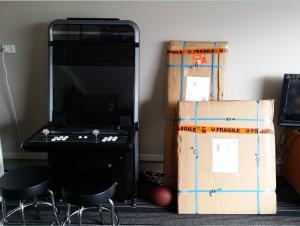

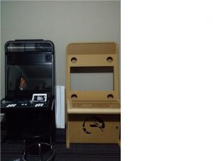

ggood82 Posted June 21, 2015 Posted June 21, 2015 Hi All I have been lurking on these forums for a few months trying to get my head around Hyperspin with varying degrees of success and then more failure however i have put that on the back burner for a while whilst i build my 32 inch vewlix clone provided from Troy at Arcadeworx ( Perth , Australia). Just a quick background with regards to the machine build is as follows . I was searching the internet for plans to build a cabinet to house a PC running Hyperspin and an Xbox 360 running RGH so i can copy all my current games onto it . Whilst i was doing this i found Arcadeworx and after some searching of their designs i decided to buy it and get the ball rolling . The price for the cabinet was approx $600 Australian dollars plus $ 100 delivery to Sydney which i had no issue with . I should have stopped there however i spent another 20 minutes looking through the internet and found a Vewlix machine machine ( 32 inch 2 player ) about 2 hours from me that a guy wanted $700 for , The Machine has a 600 in one jamma board installed which is nice but misses out on all the Mortal kombat games which is extremely dissapointing A decision was made that i should buy it and suffer my Wife's drama after , she was actually pretty happy with it once i got it home and even played street fighter 2 for an hour hahaha. In an ideal world i will build the MDF clone and sell the Vewlix at the end to recoup some costs however my 9 yr old does enjoy playing so i may keep both . I have put together the arcade cabinet now which took about an hour and i will keep you all updated on the build as it progresses . thanks all

ggood82 Posted July 3, 2015 Author Posted July 3, 2015 https://lh6.googleusercontent.com/-QRYWJiJEuQ4/VZXb_5tQ6kI/AAAAAAAADv0/_48t5RZ0SQM/w746-h995-no/20150628_103155.jpg https://lh4.googleusercontent.com/-qFuE9ZUkx3M/VZXb2da3CuI/AAAAAAAADuY/EaHwB39pa7s/w746-h995-no/20150627_103759.jpg https://lh4.googleusercontent.com/-tSoW4sJ-WNA/VZXb_rRQq8I/AAAAAAAADvw/HdiP2FpKOYA/w1327-h995-no/20150628_103114.jpg https://lh4.googleusercontent.com/-GE-T5SR-f00/VZXb9lWF1oI/AAAAAAAADvY/HDB5miUhrWk/w746-h995-no/20150628_103052.jpg A couple of links to the start of some prep work . Still a heap of work to go but for now i am sanding down and tidying up all the edges etc
ggood82 Posted July 3, 2015 Author Posted July 3, 2015 Yeah i thought so too . It was brand new with Plastic still on it . Just uploaded some pictures and am trying to do my best to seal the edges and spray without using the T moulding but if it turns out poorly i will look to strip it back and use the moulding to hide my imperfections however this may not be possible due to the way the MDF edges are Once i finish the sanding & prep work i would like to spray it all to a nice gloss finish .

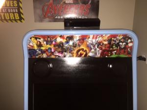

ggood82 Posted August 20, 2015 Author Posted August 20, 2015 Back again . i have now added 2.1 logitech speakers and some speaker grills that i have spray painted black . Just awaiting additional Sanwa buttons , JLF sticks & the Ps360+ which will easily allow me to add the controls & buttons to the xbox's and hopefully the Xbox one also . For the graphics i found some Avengers posters my son had that were scratched up on the corners that seem to fit perfectly so i am in the process of cutting these out and applying . Overall the job was very simple but time consuming . The only thing left is to pull the control panel off and sand the paint back to really smooth it all out and do it 100% as the job on the CP ( painting ) is sub par currently .
ggood82 Posted August 20, 2015 Author Posted August 20, 2015 Pic of the header for my panel , Thanks Big W and a $8 poster
