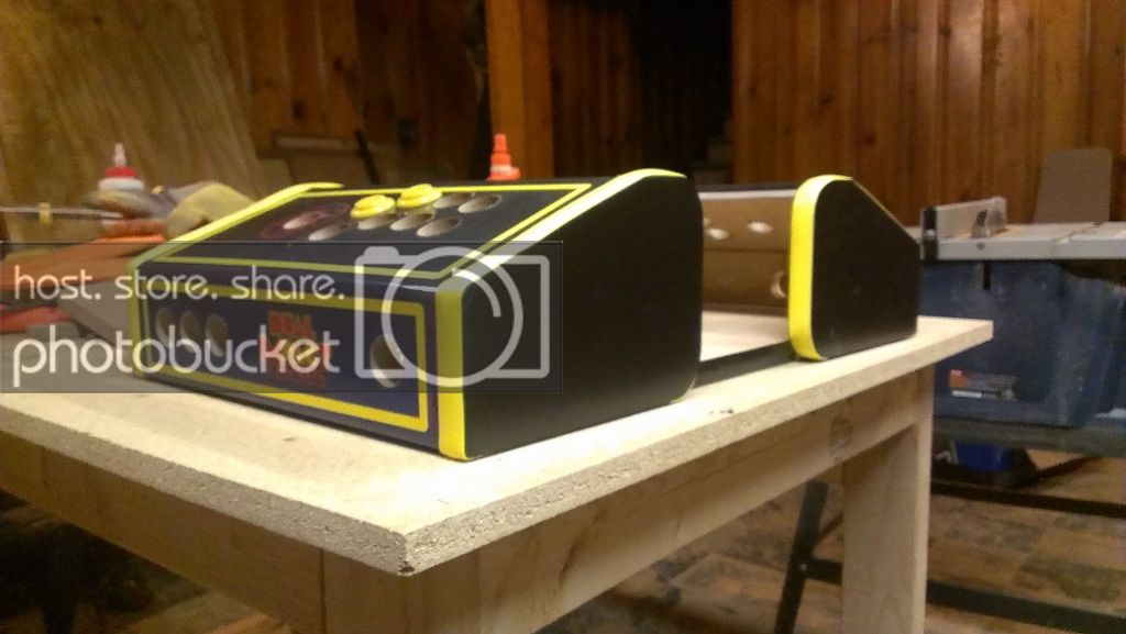

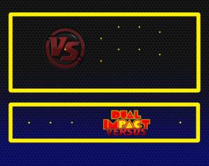

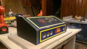

nitussi Posted April 9, 2013 Posted April 9, 2013 Decided to get back in the game; take it small and build a bartop that I had promised a while back. Starting with the Control Panel. This is what I have so far... Vertical Cab Mini Vertical Bartop Dual Impact W.I.P. Mini MvC cab Versus Bartop WIP

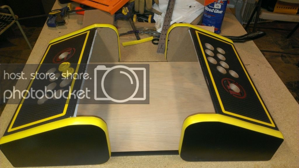

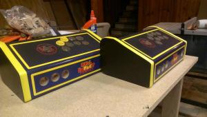

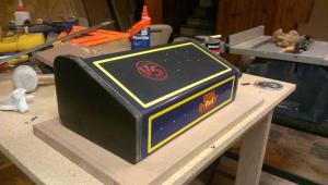

nitussi Posted April 10, 2013 Author Posted April 10, 2013 lil more progress Vertical Cab Mini Vertical Bartop Dual Impact W.I.P. Mini MvC cab Versus Bartop WIP

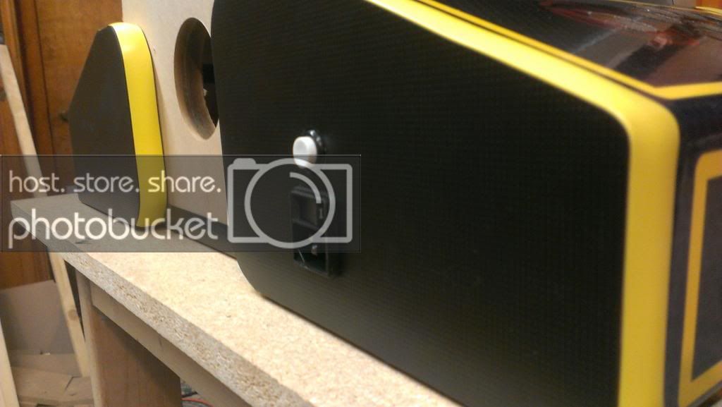

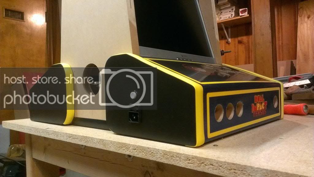

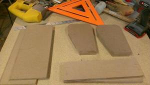

nitussi Posted April 10, 2013 Author Posted April 10, 2013 WIP Vertical Cab Mini Vertical Bartop Dual Impact W.I.P. Mini MvC cab Versus Bartop WIP
evil eye Posted April 10, 2013 Posted April 10, 2013 Wow, that's looking awesome already. A VS. bartop... brilliant!
markelhombre Posted April 10, 2013 Posted April 10, 2013 Cool! How are you gonna exploit the VS-theme regarding the software? Anything special? Is the screen gonna be horizontal? And last one: is it wise to prime your wood before you put on your decals?
relic Posted April 10, 2013 Posted April 10, 2013 thats shapeing up nicely and its a brilliant idea i wish you the best of luck on this one 100%
nitussi Posted April 10, 2013 Author Posted April 10, 2013 markelhombre said: Cool! How are you gonna exploit the VS-theme regarding the software? Anything special? Is the screen gonna be horizontal? And last one: is it wise to prime your wood before you put on your decals? Nothing special for for the software ..just two 15" horizontal monitors head-to-head; just imagine two bartops stuck together at the back. But, I may mirror(not clone) the player two monitor to allow the second player to play a game like street fighter from the left and not the right like conventional two player games. One computer with dual output video card. Not understanding what you mean about priming the wood.. after I cut the t-molding slots, I always paint the edges black because when using formica it makes the edge 1/16" larger for the 3/4" t-molding to cover; just blends better when I do not have 13/16" t-molding.. the cp's are made of MDF and the base is made of 3/4 birch plywood. Vertical Cab Mini Vertical Bartop Dual Impact W.I.P. Mini MvC cab Versus Bartop WIP
markelhombre Posted April 10, 2013 Posted April 10, 2013 You've painted you cp before you put your decals on right? I was wondering if there was a reason for that.
nitussi Posted April 10, 2013 Author Posted April 10, 2013 markelhombre said: You've painted you cp before you put your decals on right? I was wondering if there was a reason for that. Correct, I painted the edges for the t-molding before applying the art-work. As far as the art-work, that's not really decals. It's one piece printed on vinyl. Think I will be doing a pac-man theme. If you are talking about the 4 sides, that is not paint, that's formica(laminate). Vertical Cab Mini Vertical Bartop Dual Impact W.I.P. Mini MvC cab Versus Bartop WIP

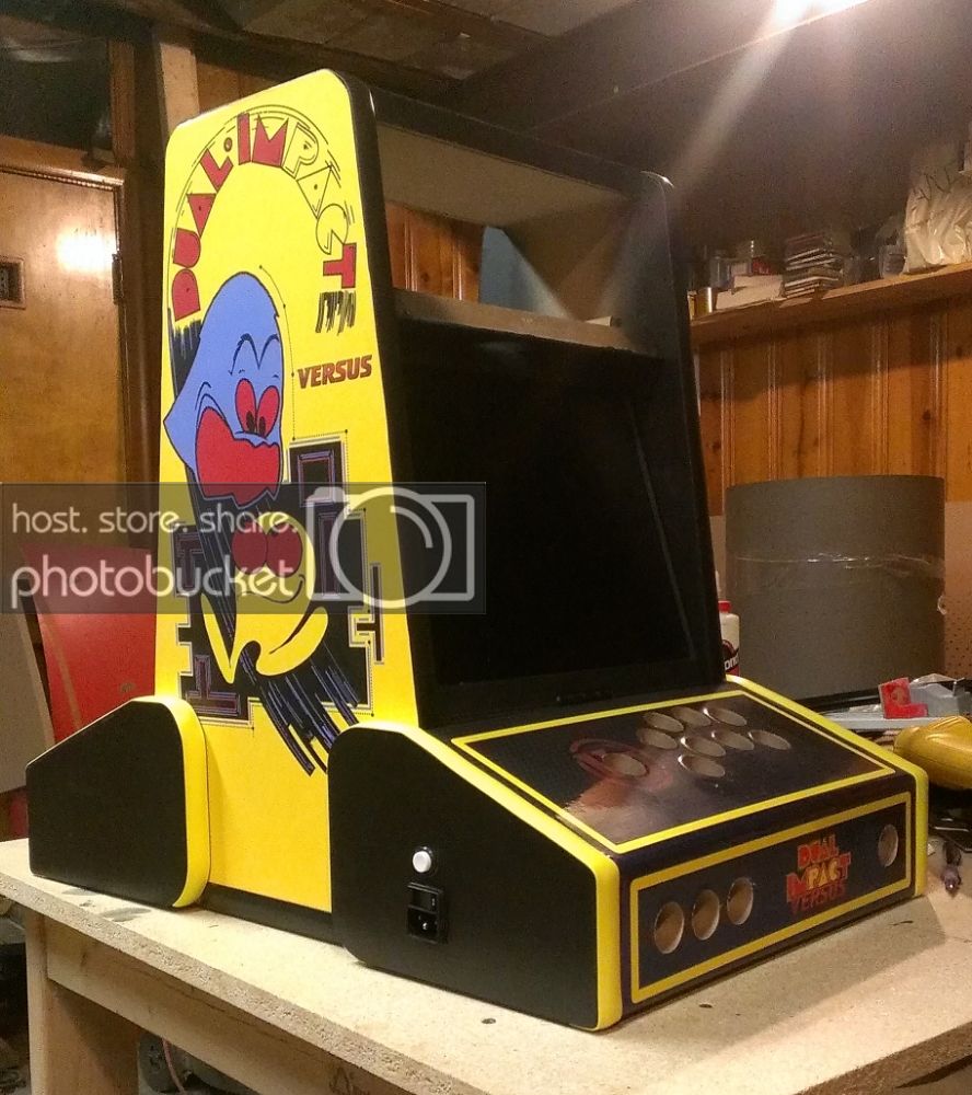

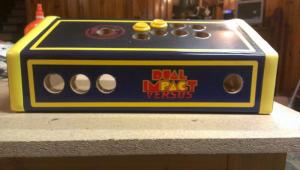

nitussi Posted April 12, 2013 Author Posted April 12, 2013 more progress Vertical Cab Mini Vertical Bartop Dual Impact W.I.P. Mini MvC cab Versus Bartop WIP

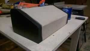

nitussi Posted April 13, 2013 Author Posted April 13, 2013 next is the marquee Vertical Cab Mini Vertical Bartop Dual Impact W.I.P. Mini MvC cab Versus Bartop WIP
markelhombre Posted April 13, 2013 Posted April 13, 2013 Wow man, impressed with your speed! You can build 10 cabinets, while i build 1!
nitussi Posted April 14, 2013 Author Posted April 14, 2013 markelhombre said: Wow man, impressed with your speed! You can build 10 cabinets, while i build 1! Well it's pretty easy when you have the idea and plans in your head for over 3 years and finally get around to do it. Tools have a lot to do with it also, just about every cut and angle for this bartop was done with my 12" sliding compound miter saw. I have a 24" printer, so printing on vinyl is no problem. It's not the best, but it's ok. Also I am no expert with photoshop either, seems every time I use it I have to learn everything all over again. Vacation time off from work helps too. Looking at the cab somewhat finished, I now know what color joystick and buttons I want to use. I have to order them. This cab is spoken for and by request, I will be starting on another one soon. Very soon. Vertical Cab Mini Vertical Bartop Dual Impact W.I.P. Mini MvC cab Versus Bartop WIP
