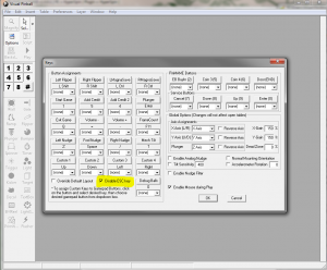

or  you could open  Visual Pinball
and disable the ESC key
when you launch a table
OUTSIDE of Hyperspin
use the "Q"  to exit the table.
WITH Rocketlauncher/Hyperspin
use your keys defined in Rocketlauncehr
YES it can be ESC (that's what I'm using)

I actually had this setting, but it didn't work.

OMG!!!!! THANK YOU ssoooooo much!!!!    I have been racking my brains for days trying to fix this thank you everything said change scripts and run this software or that your solution was painless. It works now!
