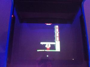

Mrmikey73 Posted April 19, 2013 Posted April 19, 2013 ok tried the new version and this is the best so far. The game is centered perfect and I can see the top and bottom of the game. The only issue is its still small, I have about 5 inches on both top and bottom but it could also be I did something wrong. I put it at 50% (tried100% to big). I wasn sure about what you meant as far as full screen. I cant click on full screen in the game it does nothing and I didnt see any options in the ahk files from djvj or chillin but if theres a way to stretch it out a little it will be perfect. Thank you very much!!!
frostyfire03530 Posted April 19, 2013 Author Posted April 19, 2013 From what I can tell it may be a monitor limitation for some people. I took the game over to a friends house (unmodded) and he couldn't enter fullscreen on 50% turned 270 degrees, like you normally can. @Mrmikey73 could you tell me what resolutions your monitor supports? My intel hd4000 on my laptop allows for 640x400, even though it's not listed in the W7 graphics settings. My current resolution I'm running at is 1366x768, but it does make the switch when called by the program. The other option would be to try to invoke 1024x768 and use the 100% scale zoom. I'd have to look into it, but I'm pretty sure it would work. I'd have to relook over my notes.
Mrmikey73 Posted April 19, 2013 Posted April 19, 2013 Thanks for your effort!! I'm limited to 640x480 using my arcade vga3000 and xp64. The game is playable just small.
frostyfire03530 Posted April 19, 2013 Author Posted April 19, 2013 Okay, so it is a 640x480... and the fullscreen option would not work correct? Edit: Would you mind posting a picture of what it looks like?

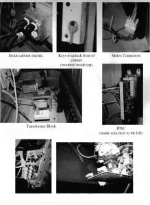

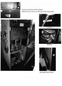

BUCKETHEAD Posted April 19, 2013 Posted April 19, 2013 In other news, Here's what's in the packet attached to the back of the Real Fix-it-Felix Jr. Machines. Enjoy.
frostyfire03530 Posted April 19, 2013 Author Posted April 19, 2013 @BUCKETHEAD: Thanks for the pictures! @Mrmikey73: Sent you a new PM, check if that works in fullscreen. Still have to work on the frame size though. The wife and I are going out to party. I might be back on later, let me know how that works.

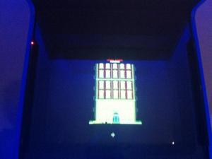

Mrmikey73 Posted April 20, 2013 Posted April 20, 2013 Here's a pic. Both files appear to be same size.
frostyfire03530 Posted April 20, 2013 Author Posted April 20, 2013 Hmm, I can't tell the difference in those pictures either! Heh. Well, I sent you another version that allows the fullscreen button to work even in 640x480 resolution. I cant click on full screen in the game it does nothing and I didnt see any options in the ahk files from djvj or chillin You can just use these parameters from a shortcut in Windows: <executable> -zoom=50 -fullscreen or if you're using the PC Games Launcher by djvj use these settings under the /Modules/PC Games/Settings.ini file: ApplicationPath = <YOUR PATH TO THE FIXITFELIX FOLDER WITH THE EXECUTABLE> ApplicationEXE = FixitFelixJr_v4.0.3.5.exe Parameters = -zoom=50 -fullscreen It looked like it was working in those pictures though. I wonder if it was because that one was still the 640x400 and it changed your res temporarily. Meh. I'll try looking for where it's sizing the rendered frame at and see what I can do. If anything, I'll ask some of my professors when my next semester starts on Monday. They might have some insight on the assembly language I've been scratching my head at.
djvj Posted April 20, 2013 Posted April 20, 2013 The only downside of fullscreen is unable to use the nice bezel. Works good so far man, if you can just get it to get closer to using the full height of my monitor it would be even better. "Computer games don't affect kids; I mean if Pac-Man affected us as kids, we'd all be running around in darkened rooms, munching magic pills and listening to repetitive electronic music."RocketLauncher's Official Home If you appreciate my work:My Apps:Window LoggerIdle Volume AdjusterExplorerRestorerRom Folder CleanerModule UpdaterMy Guides:How To Mod Guncons with Aimtrak

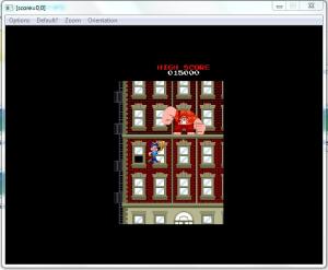

frostyfire03530 Posted April 20, 2013 Author Posted April 20, 2013 I found some code that changes the frame that the sprites are rendered in. It made it the right size, but there is a frame that needs to be resized that is around them it's looking like this now: As you can see clearly on the bottom and on the right side, you can see where the outside frame is cutting off what should be shown, the sprite frame is being rendered from the top/left corner which is why you can see everything there.
