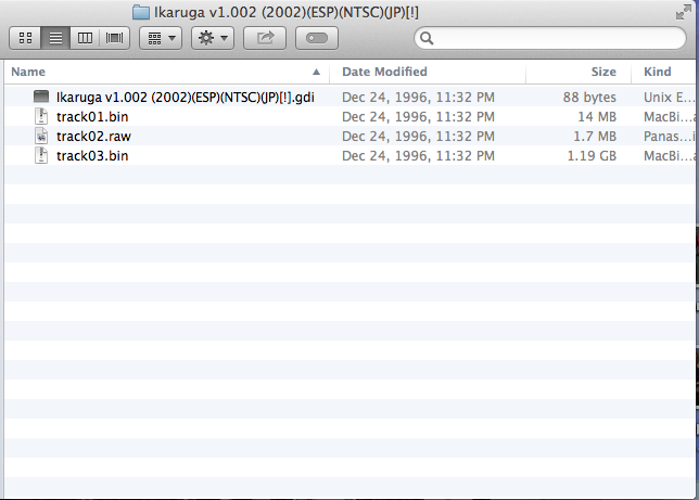

The other case, that should be something like this http://www.epforums.org/attachment.php?attachmentid=38486&d=1383832264
when you unzip and you get lots of files, RAW, GDI etc, these are the real dumped games, these will have 1.10 GB in size, because Dreamcast media was a GDI CD, that had 1.10 in space.
So, what you have to do to run these, isn't difficult, it should run the same way as the CDI, just adding .gdi to your default emulator and it should be fine.
