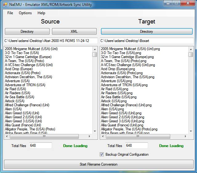

I've also attached a screenshot of the program... More to come of course.. Continuing to work out the comparison logic...

How it works:
* It will take a source directory or XML and compile a list of the file names. It then compares the naming of each file within the source directory or XML to the secondary or target directory by looking for similar text, characters, etc. If a match is found with enough similarities, it will automatically change the name of the file in the target directory.
* If there is not enough similarities between the files, then once it has completed processing, it will pop up another window to allow you to choose between the target and source, what files in the target should be renamed from the source. You can drag the name from the source onto the name in the target, and it'll automatically change it for you. (this is the first part I'm finalizing)
* Also, instead of creating a separate backup of the files, or having them rename into another folder, it will store all changes in a small database each time you run it so that if you need to, you'll be able to revert the target names back. This keeps you from having multiple directories of differently named roms, artwork, etc and having to do the whole manual copy and paste to move those that were renamed back into your Rom or Artwork directories. The information is stored with a name you provide, and includes the date it was performed, a listing of the source directory or xml and target directory, etc. There's a check box automatically selected when you start the program called 'Backup Original Configuration' that is on the main interface screen. You'll have the option to de-select it, but not sure why you'd want to. (this is the other part I'm finalizing)
One thing I'm also working on is if say the source file name is 'Street Fighter II.png' but the target name it should change is 'SF2.bin' or vice versa. This is the really fun part (sarcasm of course).
