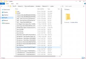

mccorkled Posted September 5, 2015 Author Posted September 5, 2015 With the last one create a folder bios in retroarch root put the bios files in there. With the bios then the E mean it requires the European bios by the looks so find the European bios and rename it exactly as it says there bios_CD_E.bin if its named any different it won't detect it I have a folder called bios and the correct files within. All mine are in the "System" folder which should be the default. That way you should not need to edit any config files. Image 1.jpg I moved mine because a few other systems needed bios files and I like uniformity. Similar to my Microsoft Dos games, they are not roms but they are all in a folder called roms. Edit: solved. Aeon Nox XIII Themes Minted Cases w/ Reflection : Minted Cases : Minted XMLs
