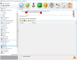

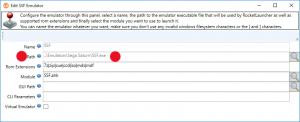

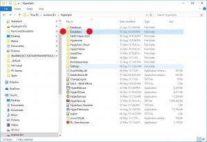

gigapig Posted September 10, 2015 Posted September 10, 2015 @gigapig: my emulation environment in installed on a USB Key (Emus, FEs, artwork ...). so depending on pc the root cout be f:\ or e:\ etc .... (mame, dolphin, project64, etc...) I'm aware of that Now I posed this as a question in my previous post. Have you actually tried using a relative path yet. By that I mean you place emulators and Roms in an "Emulators" folder inside the Hyperspin root (See pictures) I this on my test set up and it works and the paths have no drive letter.
