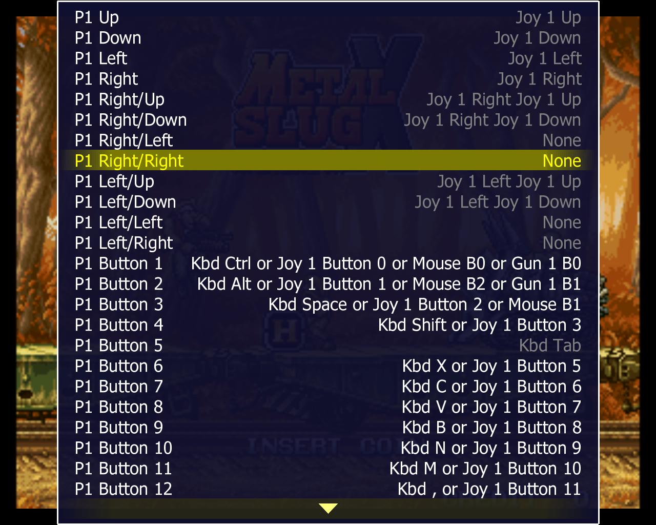

32assassin Posted October 20, 2015 Posted October 20, 2015 if your PC recognises your input device as a joystick then MAME will automatically assign joy buttons All you have to do is make sure that, the Button # in MAME matches the same Button # you wired. if you assigned Button 9 to your Favorites button than the Favorites button assigned by MAME should also be Joy button 9 if not remap the button in MAME or change the wire that is connected to your Favorites button. you should see something like this
