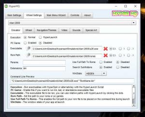

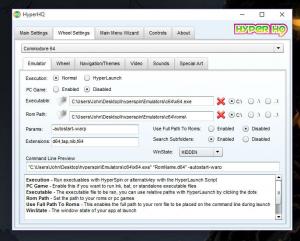

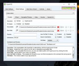

johnny50 Posted October 25, 2015 Posted October 25, 2015 I'm able to choose the option "roms only" filter for mame, and it works flawlessly. It displays only the roms I have, and runs them fine within Hyperspin. When I do this for Colecovision or C64, it just allows me to go into one or the other from the wheel, then blows me back out. Atari 2600 goes into the menu of the roms I only have, but when I go to select a rom, nothing happens. For c64, the commandline example it shows is fine if I make a batch file that has it in there or typing it from an actual commandline. Yet within hyperspin it doesnt. Anyone have any idea?

32assassin Posted October 25, 2015 Posted October 25, 2015 I want you to know that once you set your execution to "Normal" instead of Hyeprlaunch. you essentially disabled Rocketlauncher, you can actually delete it from your system and not miss a beat. this works with MAME, because mame uses the same command line to load a game (Look at the command line preview in your pictures) "emulator path" "rom name" but C64 and Atari do not use the same command line to load, You need to use rocketlauncher for this systems.
