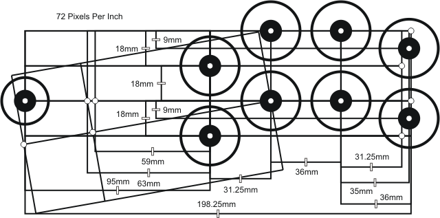

Metalzoic Posted November 2, 2015 Posted November 2, 2015 Thanks for the heads up, at this stage I'm not planning on playing modern PC games on it. I can't think of any Mame arcade games that I remember that used a spinner/twin stick so not worrying about that at this stage. Which 6 button layout did you go for? The classic symetrical two rows of three or the more Neo-geo freindly style? Don't go with a straight lined symmetrical 6. It's uncomfortable. Hold on and I'll post you some templates.
Metalzoic Posted November 2, 2015 Posted November 2, 2015 Here check these out. I recommend printing out a few at normal size to try them and see what works naturally with your hand.http://www.slagcoin.com/joystick/layout.htmlI'm going with this one: This layout uses the standard Japanese arcade design, but the proportions are set so the buttons fit together more evenly and closely. The buttons form equilateral triangles and a square.

monza Posted November 2, 2015 Author Posted November 2, 2015 Here check these out. I recommend printing out a few at normal size to try them and see what works naturally with your hand. http://www.slagcoin.com/joystick/layout.html I'm going with this one: This layout uses the standard Japanese arcade design, but the proportions are set so the buttons fit together more evenly and closely. The buttons form equilateral triangles and a square. Thanks, printed this out and does seem to fit my hand quite well. You might have convinced me to go with 8 buttons each too, guess it can't hurt to have the extra.

trailervert Posted November 27, 2015 Posted November 27, 2015 Here check these out. I recommend printing out a few at normal size to try them and see what works naturally with your hand. http://www.slagcoin.com/joystick/layout.html I'm going with this one: This layout uses the standard Japanese arcade design, but the proportions are set so the buttons fit together more evenly and closely. The buttons form equilateral triangles and a square. This is the same set up that I use. I do not have the analog sticks, just the 8way. I works great for ps1 & ps2 as long as the game uses the Dpad for movement, otherwise no so good. The button layout works pretty well it takes a little getting used to playing that way. I have found that most of the time I just pull out the 360 pad for most newer games.
