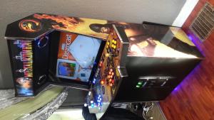

Deezdrama Posted November 7, 2015 Posted November 7, 2015 First post here. Long story short since I typed out a book and lost it a minute ago. I just finished my first cab... A couple years ago I setup a harddrive with hyperspin, full mame romset, a few other systems... I remember even paying to download the artwork etc.... Well ive forgotten all I had to learn to get that drive running right and just now got my cab done so am running into problems. Im running a 4 player cab, win 7 64, quadcore 3ghz, 4gb ram, gtx 660 Using an ipac4.... I finally got all my controls installed, installed ipac4, installed harddrive and everything was working great. Players 1,2, and 3 all worked but player 4 didnt seem to be mapped in mame. So i remapped all the controls to make sure everything was set. I dont know what happened but im getting the mame loading splashscreen popping up and cant get rid of it. Ill load a mame game and play a while and seems everytime I exit a game this loading screen pops up. I cant get rid of it by alt tabing or in task manager. The loading screen pops up and im stuck on it while I can hear another instance of HS running in the background. I havnt changed the ipac4 keys or anything else. Im clueless and going crazy.... 4 months of work on the cab and for 2 days now cant get this figured out. Ive forgotten everything about hyperspin since I compiled the drive. Do i have a key mapping conflict or something else? I know this drive worked great when I put it up a year or so ago. I dont remember the best way to map keys and never had an ipac before so that makes it more confusing as this is my first cab. Are there any guides for setting up key bindings for ipac4,hyperspin,mame? I need to add bindings for my 4 admin buttons too and dont know how. Sorry but im just overwhelmed right now, any help is appreciated!
