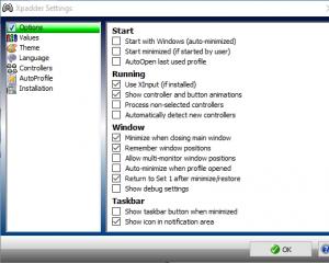

gigapig Posted November 24, 2015 Posted November 24, 2015 Here are my settngs for xpadder which seem to be working OK. Remember to back up before you mess with it.
